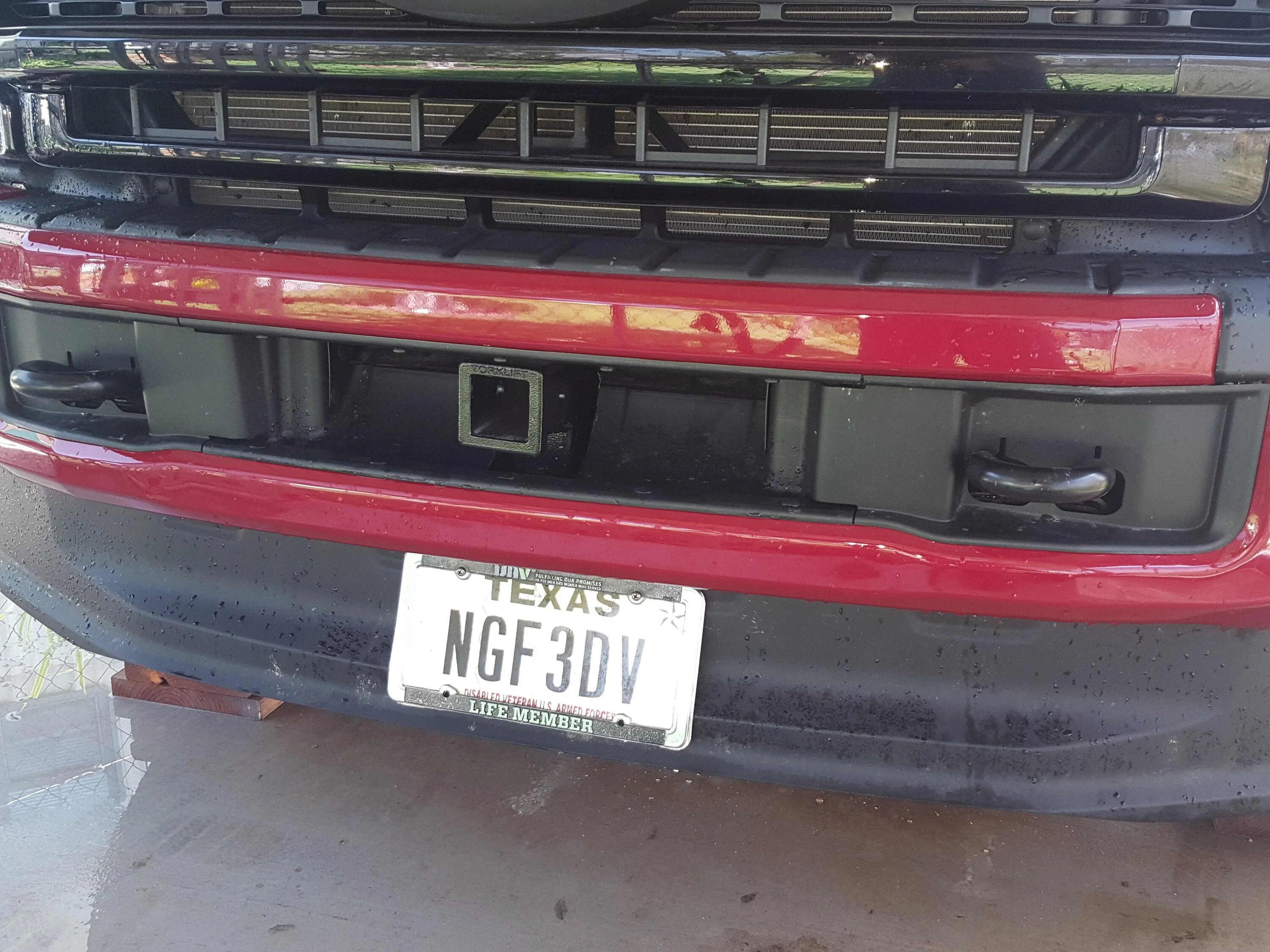

Finally had a few minutes to cut off the chain hoops
looks so much better
i made a bash plate to connect rear part of hitch frame to the factory skid plate at the engine front frame., but not sure if i need it now

Would you mind getting a picture from a little further back? I want to see how it works with the whole front of the truck?

yes i have to take one since i cut off the chain ears
this one was from a few days ago
only difference is license plate is lower and the ears
it does sort of hide and not stand out to much
