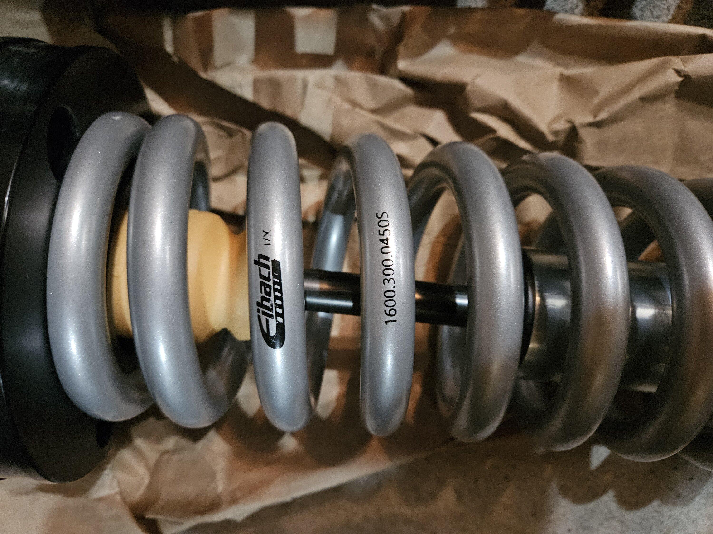

That’s a lot of preload on the new coil over.
Take a pic of the spring perch if you would.

Nevermind with the spring perch pic, I was able to pause the video and get a look at it and that looks ok.
I'm starting to think you were shipped the wrong coilovers. If you look closely at the coil you'll see the following numbers: 1600 300 04505. That means you have a 16" spring, 3" in diameter, with a 450 lb spring rate. The stock coils are a helluva lot shorter, and then yours springs are at what damn near looks to be max preload. Somebody else should chime in on this, but the coils seem really long, and a 450lb spring rate is quite low. I don't have experience with this kind of work on an F150, but I've done it more times than I can count on Toyotas and on a smaller, lighter truck folks use 600lb coils, 700 if they have a steel bumper and winch.
I wish you had a pic of the new coils laying on the ground next to the stockers for comparison. They should only be a little bit longer from the perch to the shock eye. The springs don't necessarily need to be of equal length, but they should not be drastically different either. Can anybody who has installed this kit verify some part numbers for this guy?

16” springs and 450lbs springs are not uncommon

I think this is what I will do. I am starting to accept that the stiffness is simply the max preload that was set from Eibach and what I assume would be a stiffer shock and coil than factory. Taking this strut out is actually easier than the factory with the 2" readylift puck. The Eibach is actually slighly shorter, just enough to go in and out without pulling down too much on the LCA.
@Natetroknot, below is a pic of the stock passenger side and the Eibach coil for the driver side that I have not installed yet. It's slightly shorter in total length, even with the max preload.
I'm heading out to the garage to finish this up. I'll take the eibach strut back out and see if I have full motion or if anything is binding. If it looks good, then I'll proceed with the install and then do the driver side, and hoping that the test drive will show that my concerns were all for nothing.
