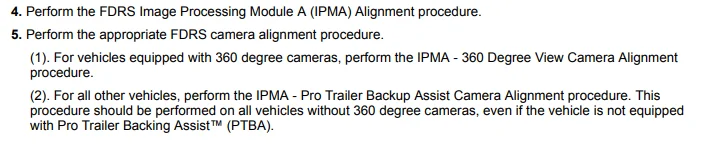

Is there a sequence you need to run the calibrations? I.e. 360 first, then alignment? Most of the TSB's (like 22-2109) reference alignment first, then 360 Calibration:
