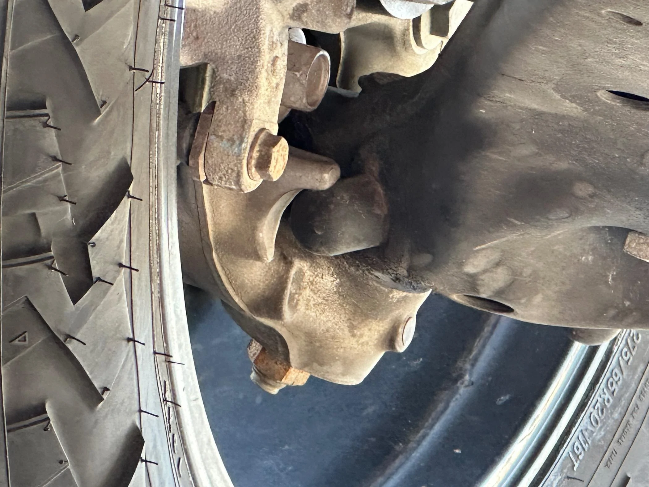

Hey all, installed the previous gen Roush Fox coilover on my 2021 Powerboost. Noticing that it’s making a kind of metal popping or clunk sound when I’m turning at slow speeds. The sound isn’t consistent, sometimes it’s a bit louder/more pronounced than the video.
Torqued a few things quick and all seemed to spec, going to spend a little longer tomorrow going through everything. Don’t see unusual wear on the steering stop deal and it happens in 2wd, so I’d assume it isn’t the cv axle binding but maybe.
Anyone have any idea what it could be?

I had the same issue after having the Fox 2.0 coil overs installed. Happened (popped) almost every time I made a sharp left turn into my driveway. Took it back to shop where they were installed and to fix it he said they did a little grinding on the steering stop on the knuckle and greased it. It worked in my case.

Appreciate it. Yea I figured that may be the problem. I didn't take any before photos so I don't know what "normal" is here but there's definitely contact there. I could see the noise being the steering stop on the knuckle "popping" off the black part under pressure as you turn the wheel.
I assume they grinded the bottom of the knuckle part down a bit, I'd assume at an angle so the black part slides off a little easier. Any chance you could take a pic of yours?
May be a good excuse to just buy the Icon Tremor knuckles lol

Hope this helps!
that's perfect man, appreciate it! And pretty much how I assumed they would shave it down
