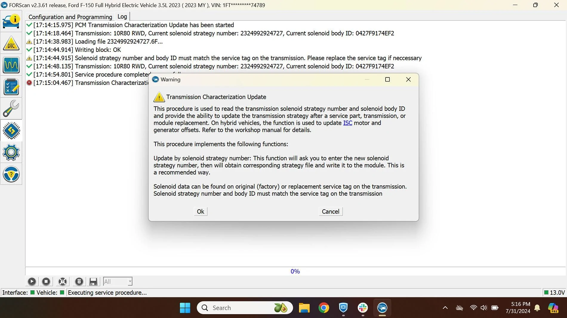

_Ryang22_
- Thread starter
- #1
Got forscan and changed the following codes listed below. Everything worked great until i went to change a couple more things the next morning. it was saying i needed a "Transmission Characterization Update" leading to changing the solenoid strategy number (i attached screen shots for better understandings). Havent touched the trans or any part on the truck. Im sure its something i did but just cant figure out what.
bdyCM
double honk on leaving cabine -- changed ON to OFF
Using high beams with fog lamps -- changed OFF to ON
tire pressure monitor -- changed ON to OFF
IPC
reverse brake assist -- changed ON to OFF
approaching vehicle audible system -- changed ON to OFF (also disconnect pedestrian wire beneath glove box)
bdyCM
IPC
