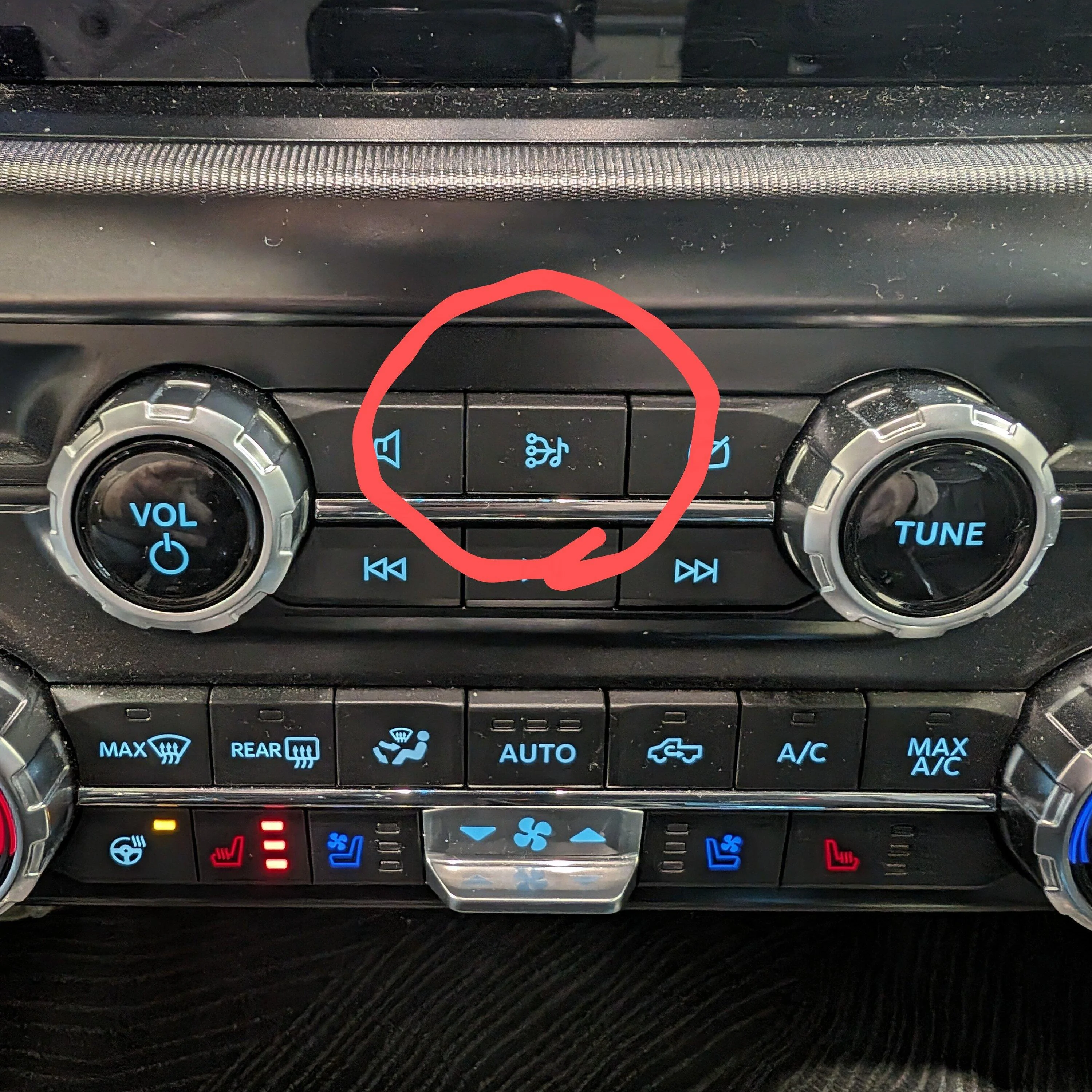

Appears to be a change to try and see what happens. I wasn't aware of cycling through options. I guess I need to look at my buttons. Used to just tell truck by voice what audio I wanted in my 2011 and the sync lady took care of it. No button pushing required.
oneinch
oneinch
Apr 17, 2022
36
629
565
Philly area
2022 F150 Powerboost, 2022 Maverick Lariat Lux
Physical button to cycle through audio sources. No need to change screens. Hiding unused options would be nice.
