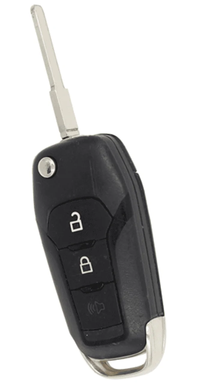

Ah, TIL - I didn't even know a regular key was an option. I drove an STX a few weeks ago but I think it was an XLT. It had one of the keys with integrated fobs, like this.
That's what my key looks like.
Gangster with a switch blade ... key. .. lmao
Oh yeah, now that I think of it, while it's still a fob, even if there was a double-honk you wouldn't be able to trigger it since the key needs to be in the ignition for the engine to be running. That should have been obvious. ?
Yeah my truck isn't too fancy I still have a blade key. It's switchblade tho. Lmao
