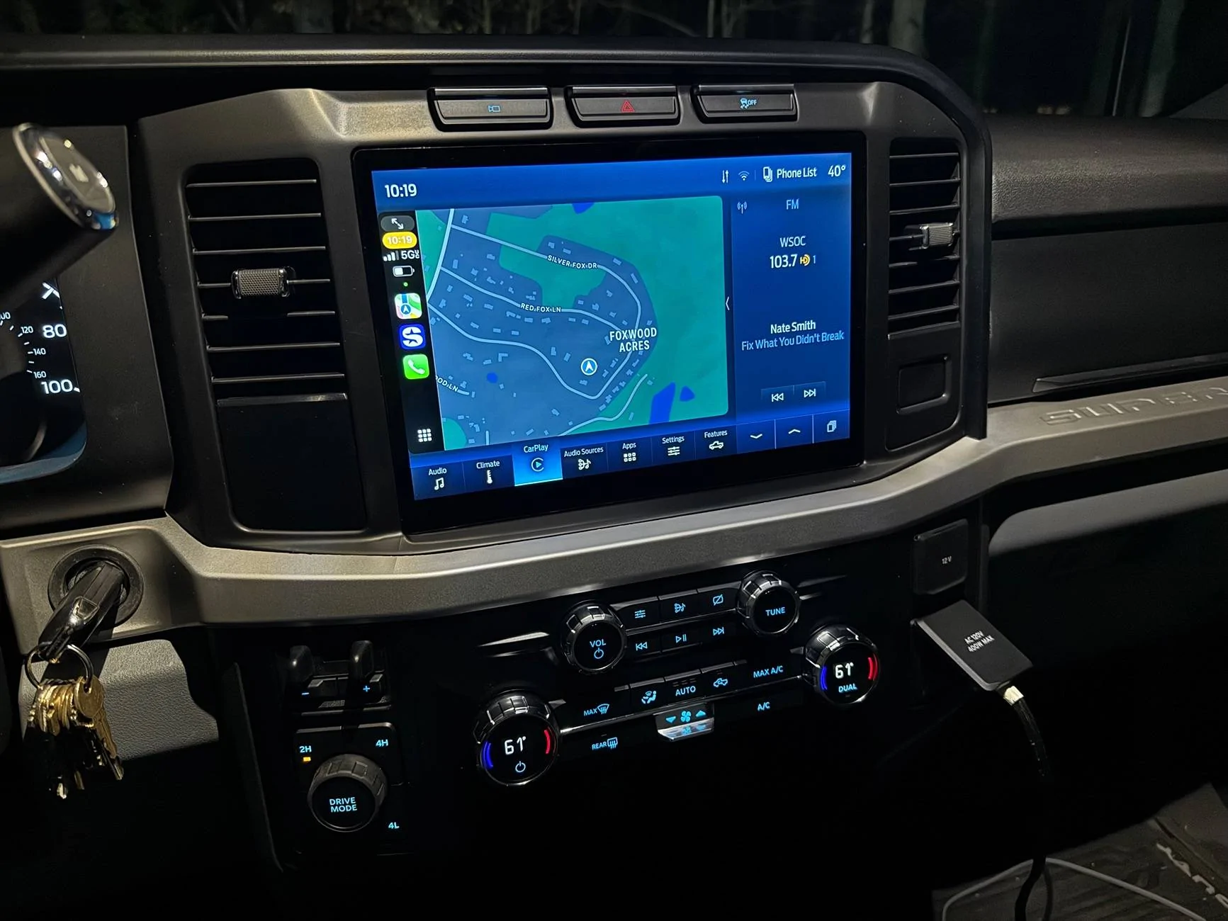

I just installed this on my 2024 XL. I have all functionality (Defrost, Auto Temps, Temp Digital readout, Cold A/C, Hot A/C, Recirculating, Max A/C, Knob controls) but my rear defroster is not turning on via the HVAC dash controls.
Additioanlly, do not have a 'climate' menu in my Sync menu and the temperature display is only showning on the left side. How can I activate this on my passenger side?
You will be able to turn on the passenger temperature repeater in Forscan, although it will not actually do anything because our poverty specs do not actually have the components to use dual zone climate.
Mine actually messes it up if I turn the passenger knob to anything other than what the driver is set to. But I do have the temp displayed because I think it looks better.
The truck that the module came out of may not have the rear window defroster, if thats the case you'll have to enable that in Forscan as well.
