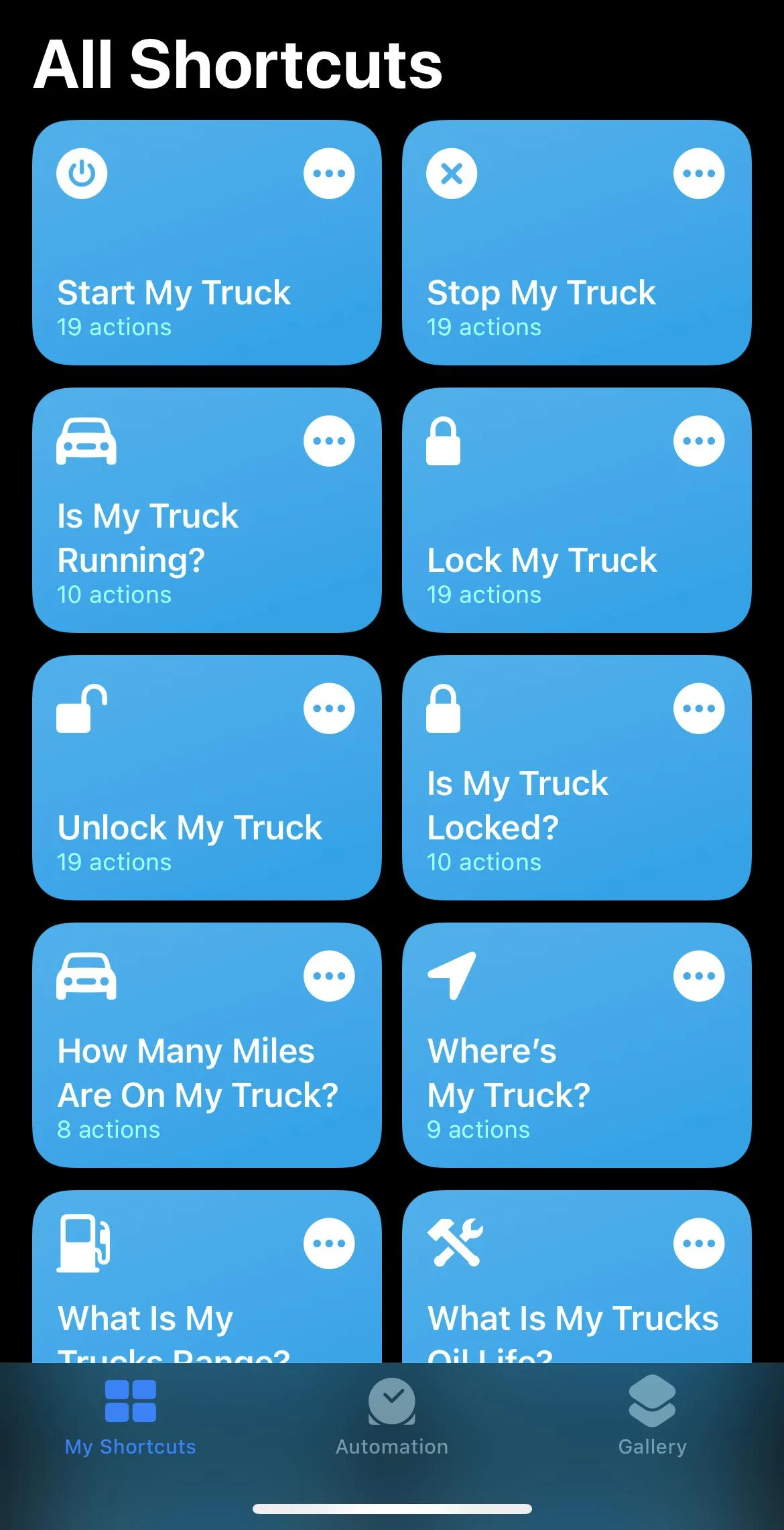

Has anyone pinned down a way to add a Siri shortcut to start your truck with just a Siri command?
I have the core logic in the script that will work with a Special shortcut allowing any supported command to be submitted to the widget. I just need to build out the parser. It will allow for far more advanced commands.
This is coming in v2.0 of the script.
No more need for multiple shortcuts it will all be handled by the same widget script and a single shortcut.
