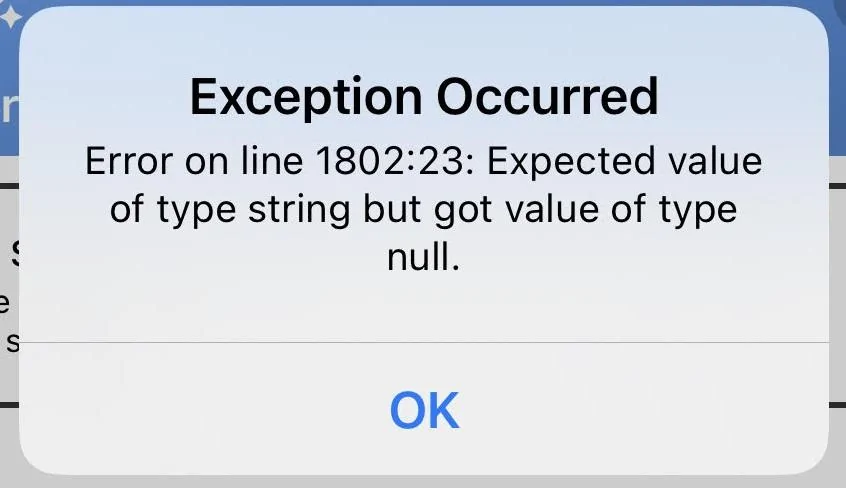

Great job on the Widget. Below is the error I keep getting.
Ford F-150 FordPass - Scriptable Widget (iOS, iPad, MacOS) EBCD669F-8932-44BB-B444-F45AC85AB56E

Script has been working great until this most recent version. I just updated to latest version as of 8:30am EST 12/17/2021 (v1.2.3) and ran into an error. First of all it prompts me to re-enter my credentials (which are already populated) and after doing so I get this error:
Ford F-150 FordPass - Scriptable Widget (iOS, iPad, MacOS) fordpass-scriptable-error-12-17-2021
Tried rolling back to v1.2.2 and v1.2.1 same problem. Had to go back to 1.2.0 to get it working again.

Hi tonesto7,
I found an issue where if you do not enter your VIN in all caps on the first screen after loading you get an error. I was able to correct it by going through the code and hard codeing my VIN in all caps then loading then removing all saved data then re-copying the script and reentering login info with VIN in caps. I would suggest if possible making a way to delete the saved data UN, PW & VIN after install. Also I would note that the VIN must be in all CAPs when entered. Other than that this is a great tool.

If this is true... I can force the text to uppercase

I would also suggest a way to erase the login details (Saved Data) post-install in case something went wrong.
There is a flag in the script code called clearKeychainOnNextRun that can be set to wipe all data
I'm going to add some validation checks to the VIN data on start to look for lower case and convert then save to upper case. As well as a validation check on vin saves looking for correct length and characters.

First time install. Ran and got
Getting an exception occured on line 1912:53 Type error underfined
ver: 1.2.3

Make sure you copied all the code from the RAW page on Github. Also make sure you enter you VIN in CAPs.

Did that.... Any idea what line the vin number is on?
Doesn't seem to allow you to enter it in after saved.

Try using the suggestion by Tonesto7 below:
There is a flag in the script code called clearKeychainOnNextRun that can be set to wipe all data.
Once you do that then change the flag back and you should get the login again. Or re-copy and paste all the script again after.
