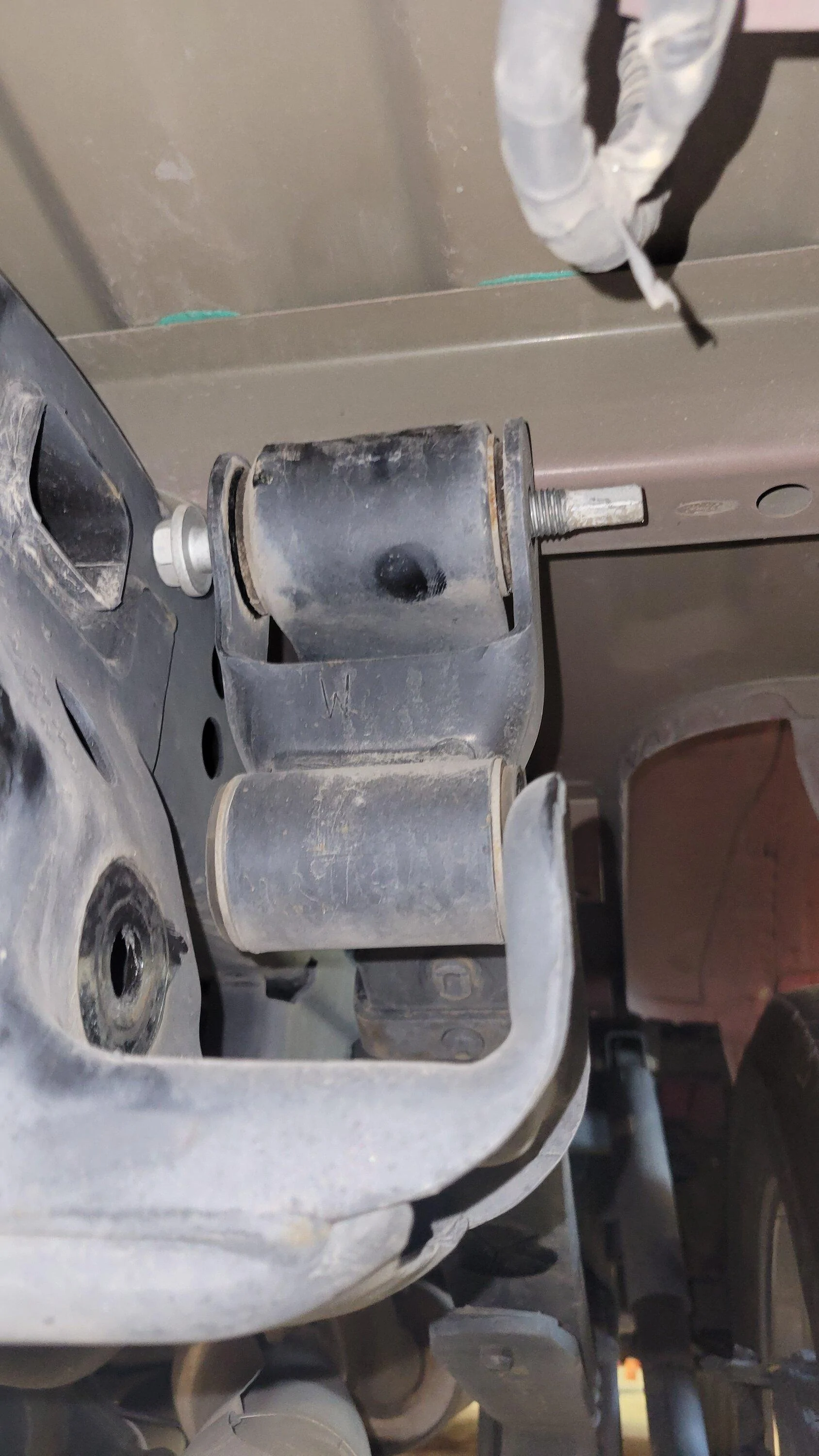

That is what I did. The springs are touching the bed rail in the Pic. Did you just keep jacking to quasi for the spring eye around the bed rail?
I figured it out.... I was not putting enough arse into the jack. When I did, the spring popped up there!

22Spacewhitexlt how did you get the spring bolts out on the too? My frame rail is still in the way with the springs pushed to the bed. Help!
I lowered the truck by the hitch with my jack to get the spring above the frame and around the bed support. A little at a time and check and repeat. Slap jackstands under the frame after the bolt clears and you’re all set.

I didn’t even take my wheels off when I did my shackles.
