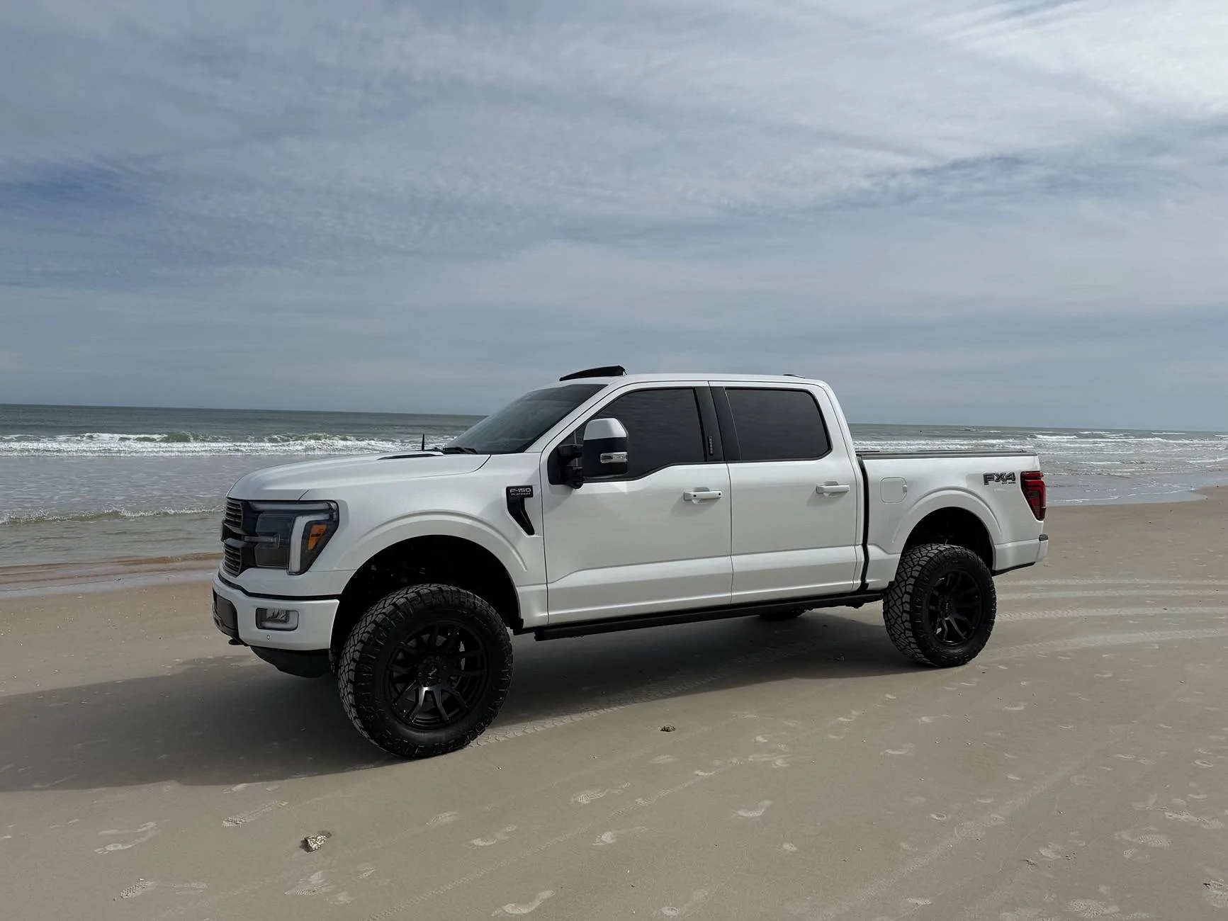

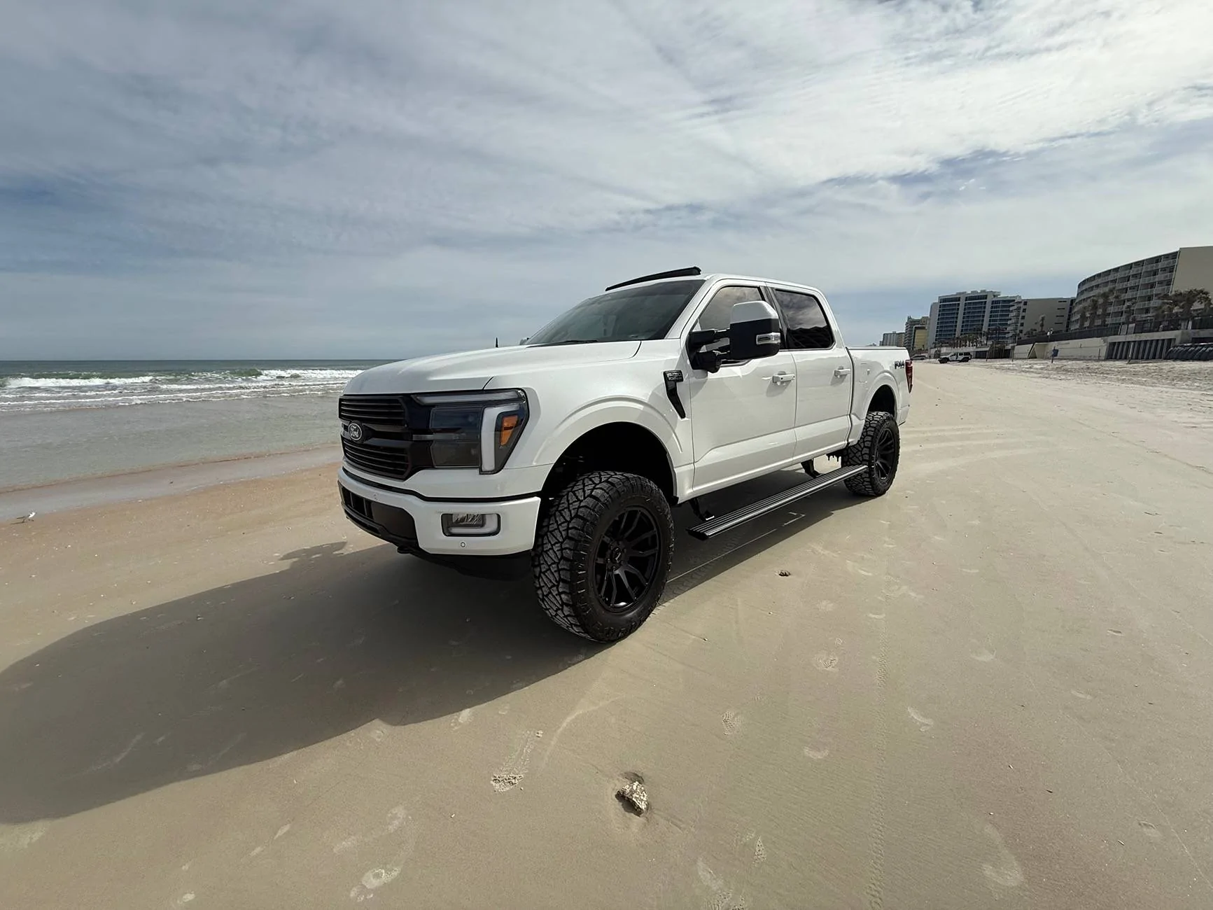

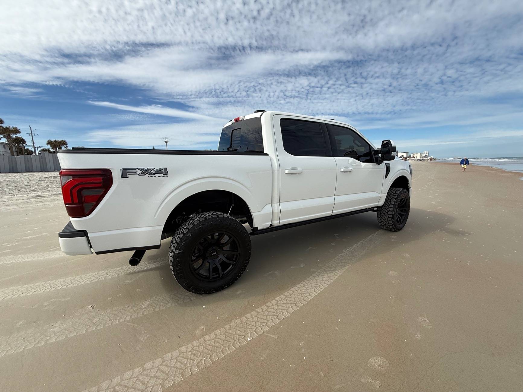

Sorry for the late response
Your truck looks great! Thank you for sharing your thoughts on installing prb's. That is one of my summer projects.
