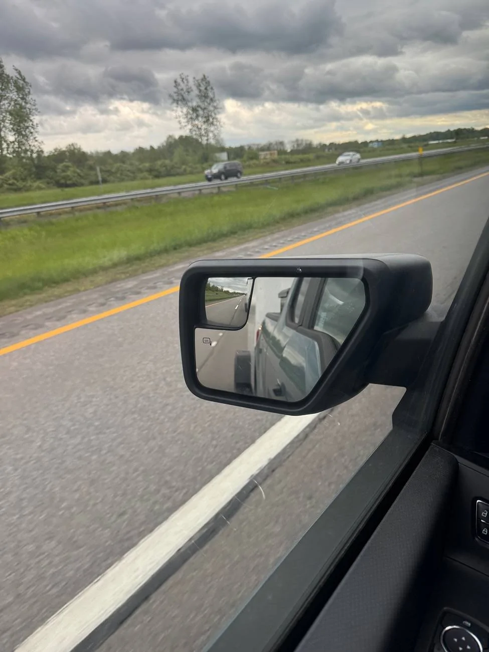

I have read alot online from people who have never owned or driven the V8 nor 3.31s on how terrible the towing experience is. I’m still looking for the supposed drama they say i will experience between my boat and other trailers. Hauled my dual axle enclosed loaded to the gills with tools, ladders, pipe, and tanks for 2 hours yesterday, 8th gear in tow/haul the whole way.. Moral of the story is if you tow between 5-8,000 LBS I would not shy away from a 3.31 lot truck if you like it and I read this happening all the time. They do just fine, you are going to be in overdrive the whole time lol. Mind you there was also decent head wind on top of the weight.

I agree, the 3.31 gears in conjunction with the 10-speed automatic transmission make a good match and offer both good acceleration and fuel efficiency even while towing. Also, my 0-60 run of 5.41 seconds says there is plenty of mechanical advantage too. ?

Yup, it occasionally drops to 6th or 7th on a heavier incline but that’s about as much “drama” as I’ve ever seen. Goes right back up to 8th gear on the flats.
This is really good to know and we all appreciate your evaluation of the capability of the combination of the 5.0 and 3.31. On a different note, how did you get the display to read as you have photographed? Is Forscan required? Thanks.
