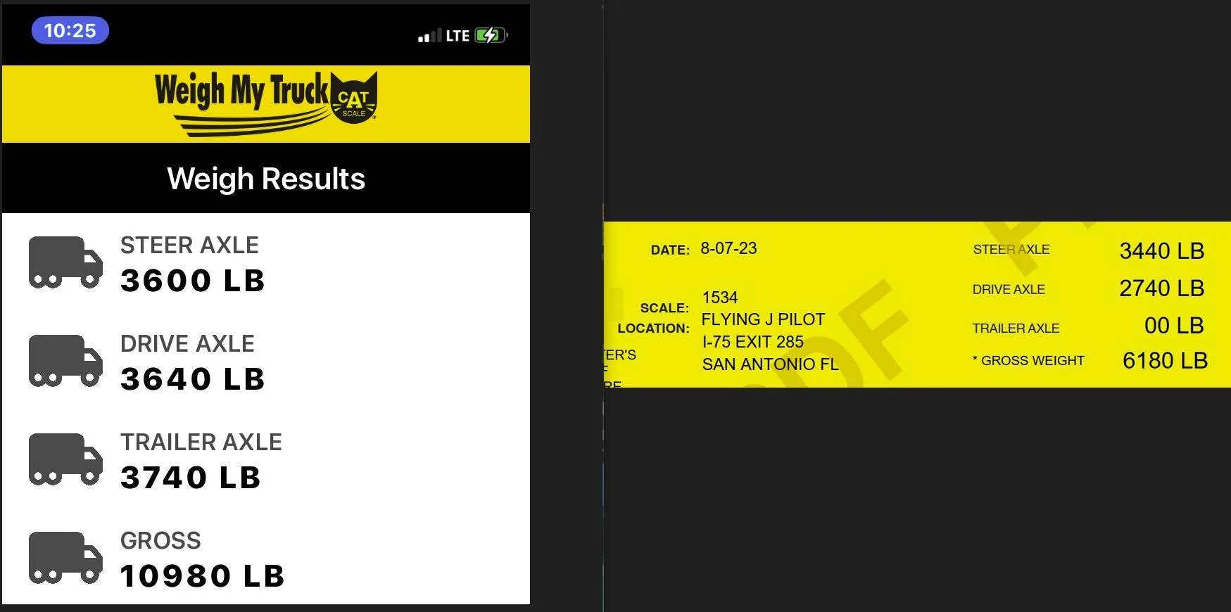

I think you'll be fine. My issue with the Powerboost was the hybrid + high trim + short bed made for the worst possible pay load config. If I was to do it over and go for an F150, I would get a long bed Ecoboost or V8. I now view the long bed as a must for towing a travel trailer on a half ton.
All that being said, we are out in New Mexico right now with the new rig, and I have zero regrets going 3/4 ton. The tow was so much better, and my specs on the trailer are similar to what you are thinking and with the scale on the Weighsafe, we approached 950 tounge weight, which meant with only our bodies in the truck, we would have already been over payload in the F150.
I'm no towing Nazi and I feel that the OEM tongue weights are unnecessarily low as long as tires, shocks and a WDH are utilized correctly. I myself have towed well over what my PB should have towed.
That said, you do enough RVing, your family's safety and others & you have the means, that you did the correct move.
You'd also get like 4mpg pulling that trailer with a PB! Your new set up is really nice, congrats!
