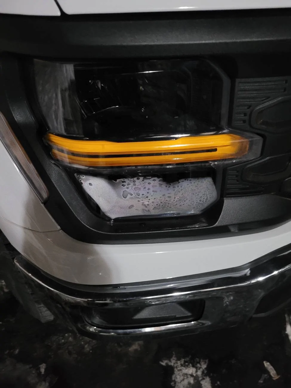

I bought a new 2024 F150 XL an i drive from the dealer to my home at the first day and fog inside my 4 headlights appear (pictures). This disappears after one or 2 days. Each time i drive my truck this appear sometimes with frost at about 20 F and less and disappears when the truck don't moove for 1 or 2 days. Ford said it's normal. When the lights are frosted inside, they don't light up as much and I think if they breathe, the humidity will carry dirt inside my light. Your recommendations please.

Thank you! If i well understand what Ford said: the condensation disapear during driving time... In my case the condensation appear during driving time and disapear during the truck don't moove.

My 2023 (different headlamps) gets some on the very bottom sometimes. Maybe a couple inches from the bottom. It isn't nearly as all-over as your photos show. With that said, I bet Ford will say its normal.
I can deal with a little bit away from the primary headlamp beams. Yours I'd be more inclined to look into. Unless what I think is fogging is a reflection off the headlamp?
I will say Ford does / engineers a lot of things they consider "normal" relative to other vehicles I've owned. Noises and humming and clicking and I've not had any other car with lights that fog like this either.
MPro
Jan 13, 2025
Quebec
2024 F150 XL

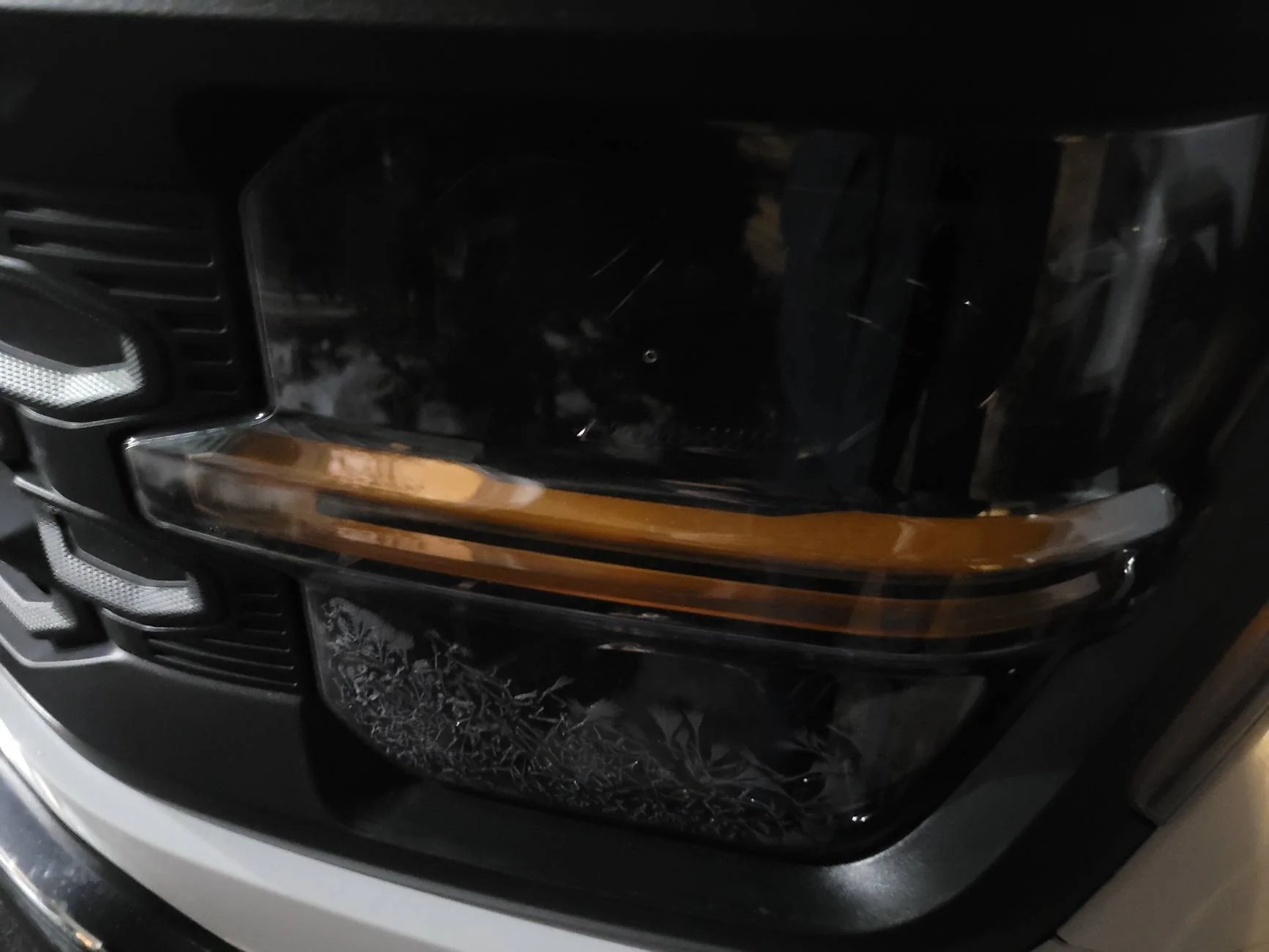

Sorry, after checking i think it's possible we can see snow reflect inside the driver side head light...but upper this we can see the condensation i think (picture taken 1 month early). if i understood correctly what you said. It's not easy to take a picture without reflect... but for this day it's too late. I added the passenger side head light picture for this same day.

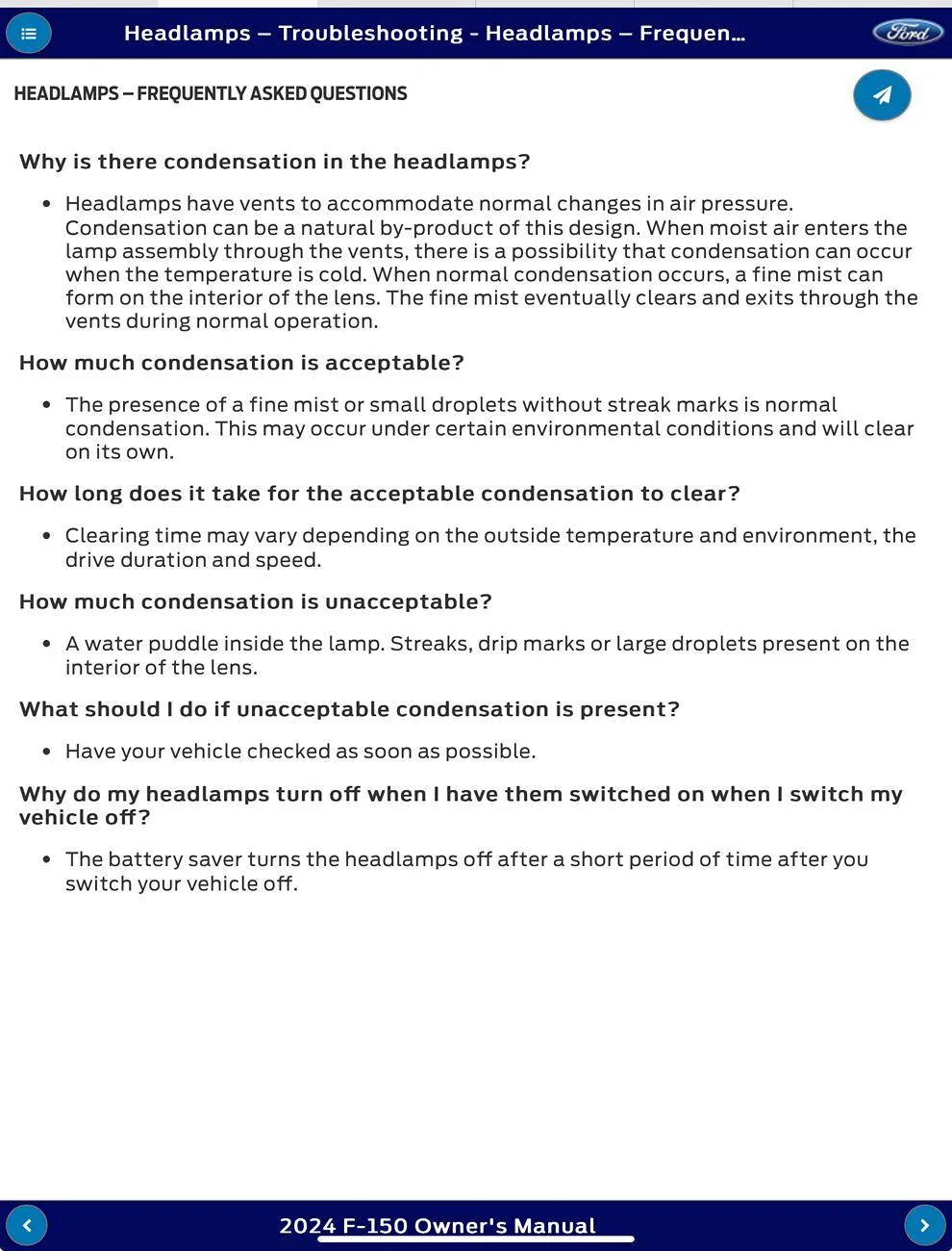

Here is screenshot from my link. Maybe that will help you.

I had read manual from your link. May be Ford USA have a other way to treat this ..
On the top right side of my page 164 , Ford said (i translate) ''What is the condensation quantity acceptable'': ''A thin condensation cover less than 50% of glass.'' After 38 km last tuesday as those pictures. Do you think it's a safety issue? Ford Canada said it's normal. What do you to fix this issue?
