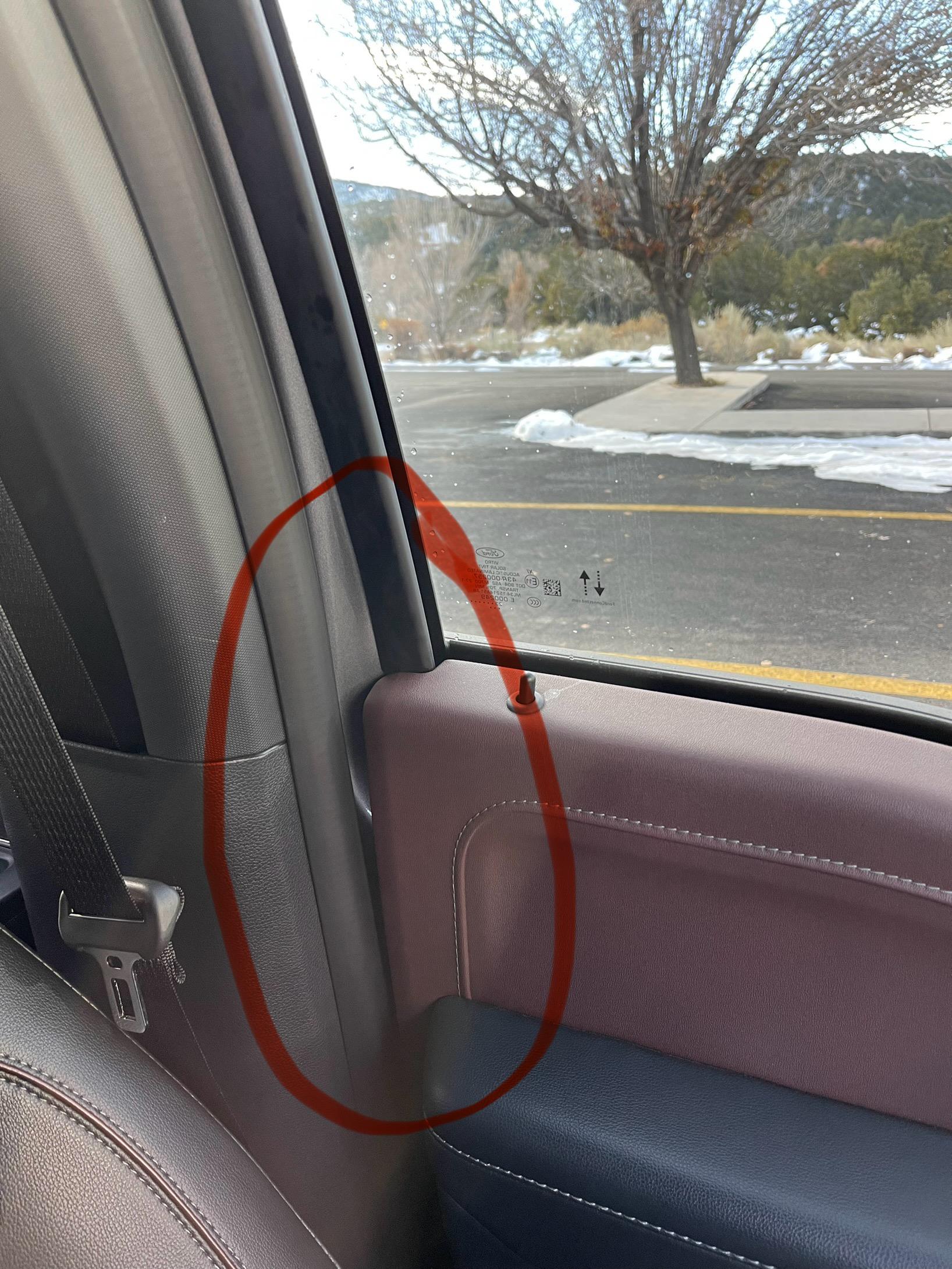

Just bought a power boost and wanted to see if anyone else has been experiencing this. There’s like a wind fluttering noise coming from the driver side door area. Happens around 65 mph and above. Can’t seem to find anything and it’s annoying.

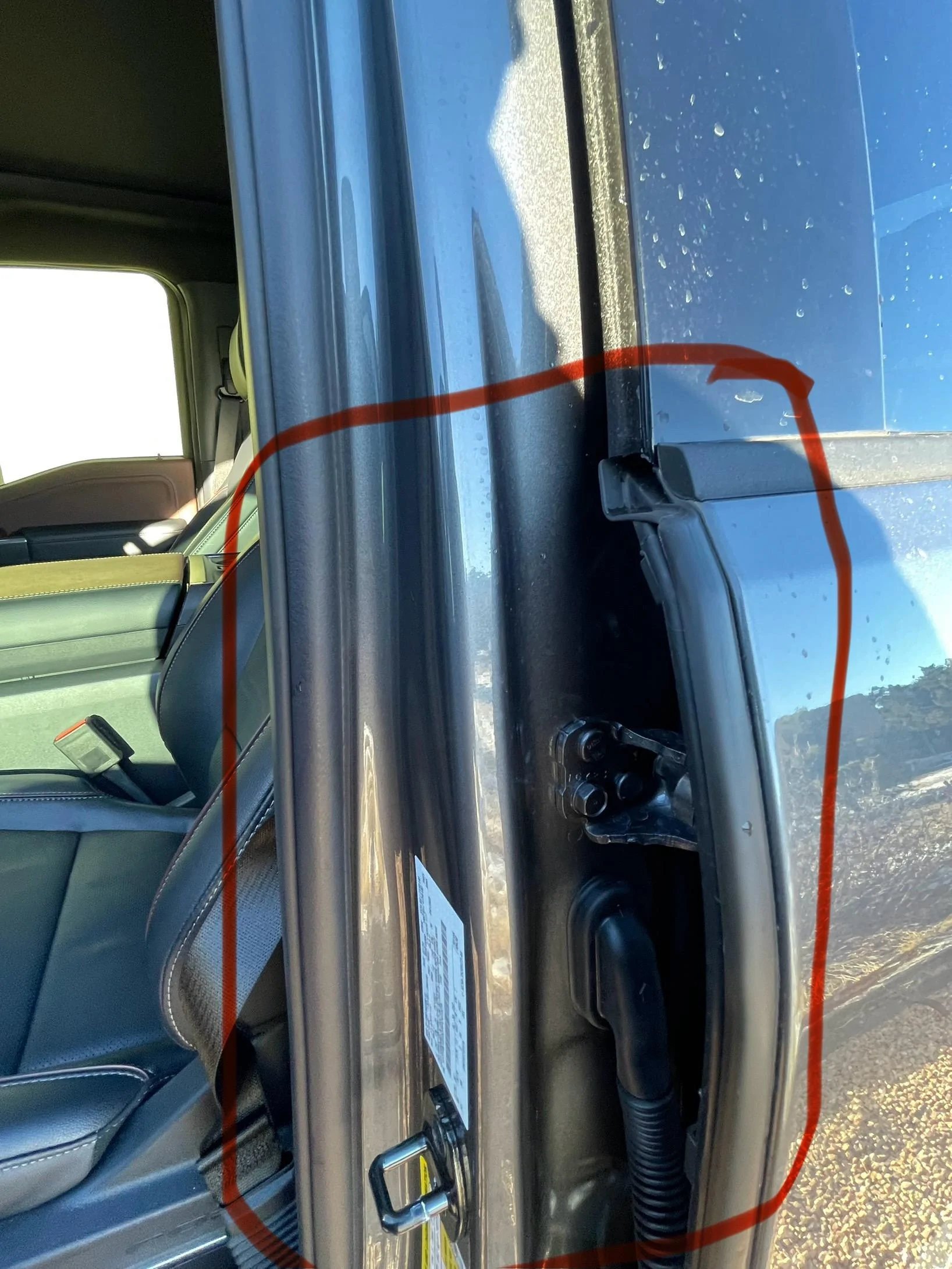

Can you take a picture of the area of the door and frame seals with the door open where you feel the fluttering is coming from? Maybe we can go compare our seals as well.
Lee85
Leander
Nov 4, 2023
New mexico
F-150
Ford F-150 Fluttering noise IMG_0924
Ford F-150 Fluttering noise IMG_0922
Feel like it’s coming from these areas.

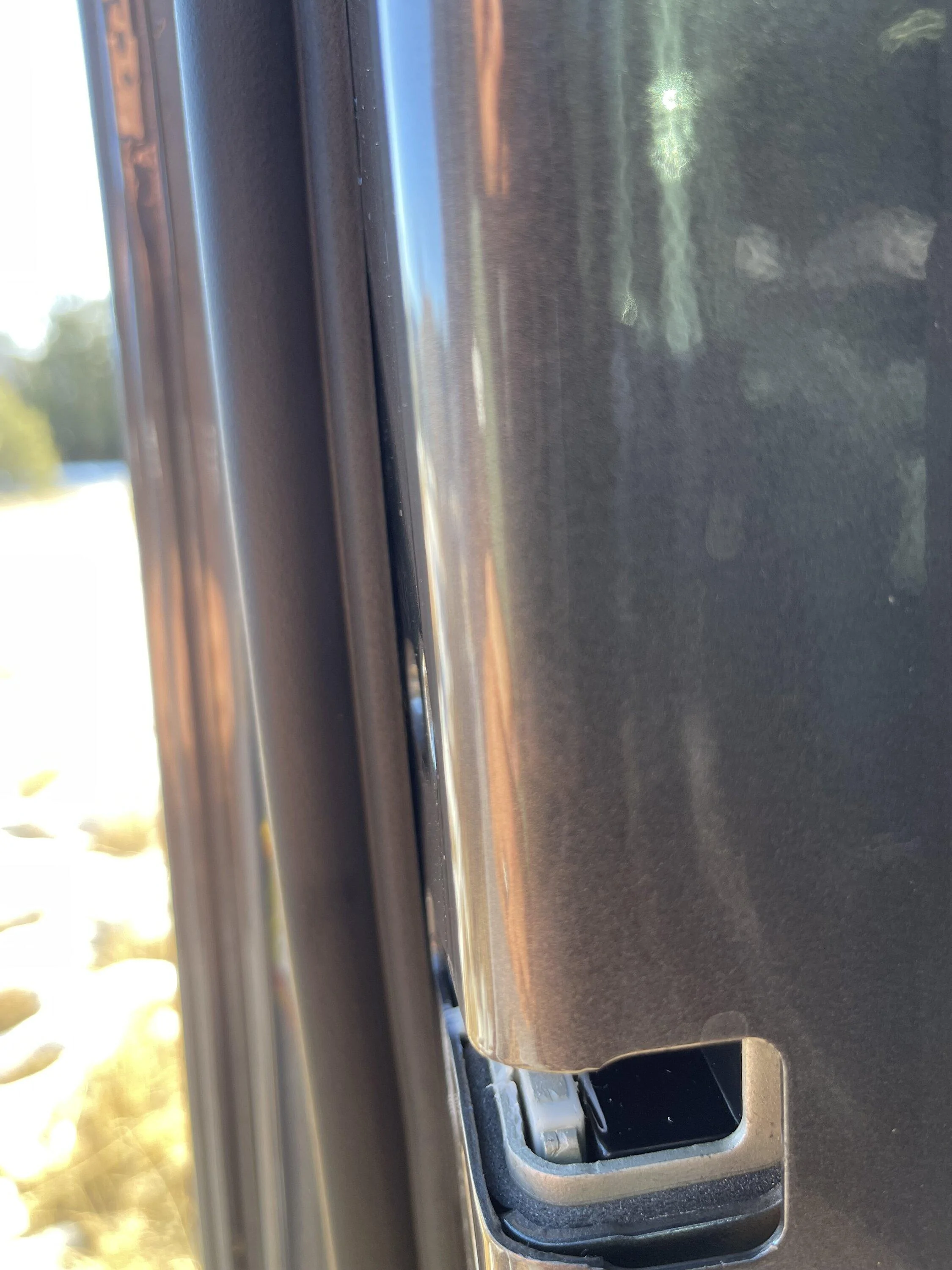

Also, if you run your hand/fingers against the rubber striping, are there any gaps that maybe the glue did not get affixed or its not sealed against the metal?
Lee85
Leander
Nov 4, 2023
New mexico
F-150
Ford F-150 Fluttering noise IMG_0926
There’s a gap her on the door and the stripping isn’t glued. The frame stripping is glued down.
discothan
Jan 4, 2021
728
690
SW Michigan
2021 F150 XLT
Might be a simple fix or run by the dealer and see if they can glue this down for you (let them know what the problem is). Keep in mind that it might need time to cure/adhere before taking it for a test drive.

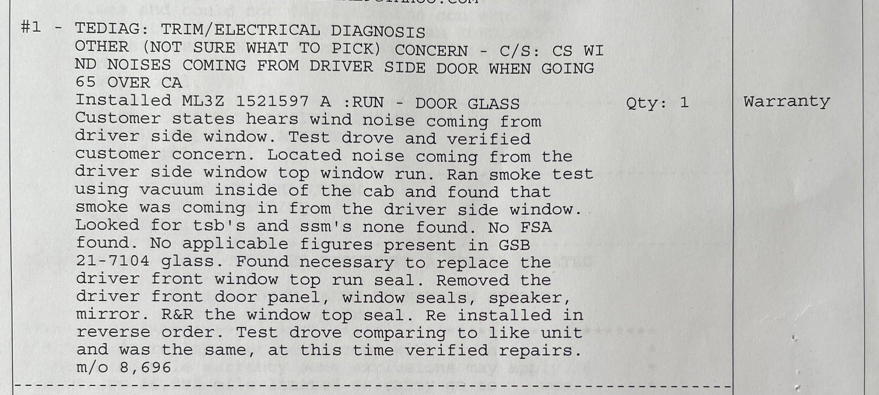

Did it fix it?
Mine makes a strange noise at unmentionable speeds, right in that same area.
Lee85
Leander
Nov 4, 2023
New mexico
F-150
Did it fix it?
Yes for the most part. Before I would drive with the music down and can hear it pretty consistently. When I leaned my ear next to the door I could hear it pretty Clear. Now with the same thing I can’t hear it consistently. With my ear next to the door I can barely hear the flutter noise.
