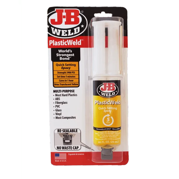

I would suggest using the 2-part plastic epoxy for this, I’ve done it to a friend’s XLT when his came in; still waiting on mine to come in. It’s been holding since winter, no issues so far but prep is key! I’ve seen a few people use 3M dual sided tape, some have said it popped off and some has worked for some people. I love using 3M double sided tape as it’s easier to swap out if you need to with another badge but 2-part plastic epoxy is a lot better and stays in without it popping out and losing it on the road lol. Be sure to test fit it to make sure it sits perfectly the way you want it before applying the expoxy and use clamps to hold the badge in after the export is applied for a few hours to be safe

Which did you use? JB weld, Perma?

JB Weld, it held really good. Just be sure to squeeze out the little bit off when you open it then screw the tip on; ensures it’s mixed properly. They have a 5 min one and a 15 min one. I just clamped it for about 2-4 hours, then mounted it back on the truck.
JB standard or the plastic ?
