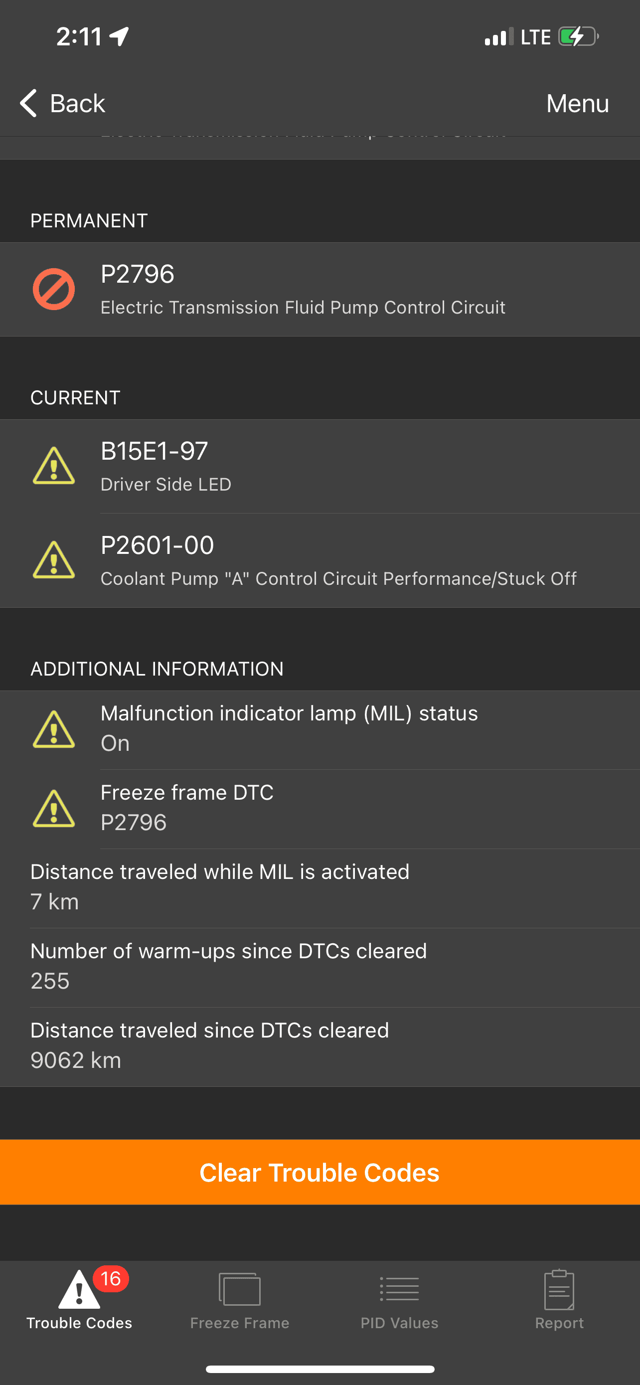

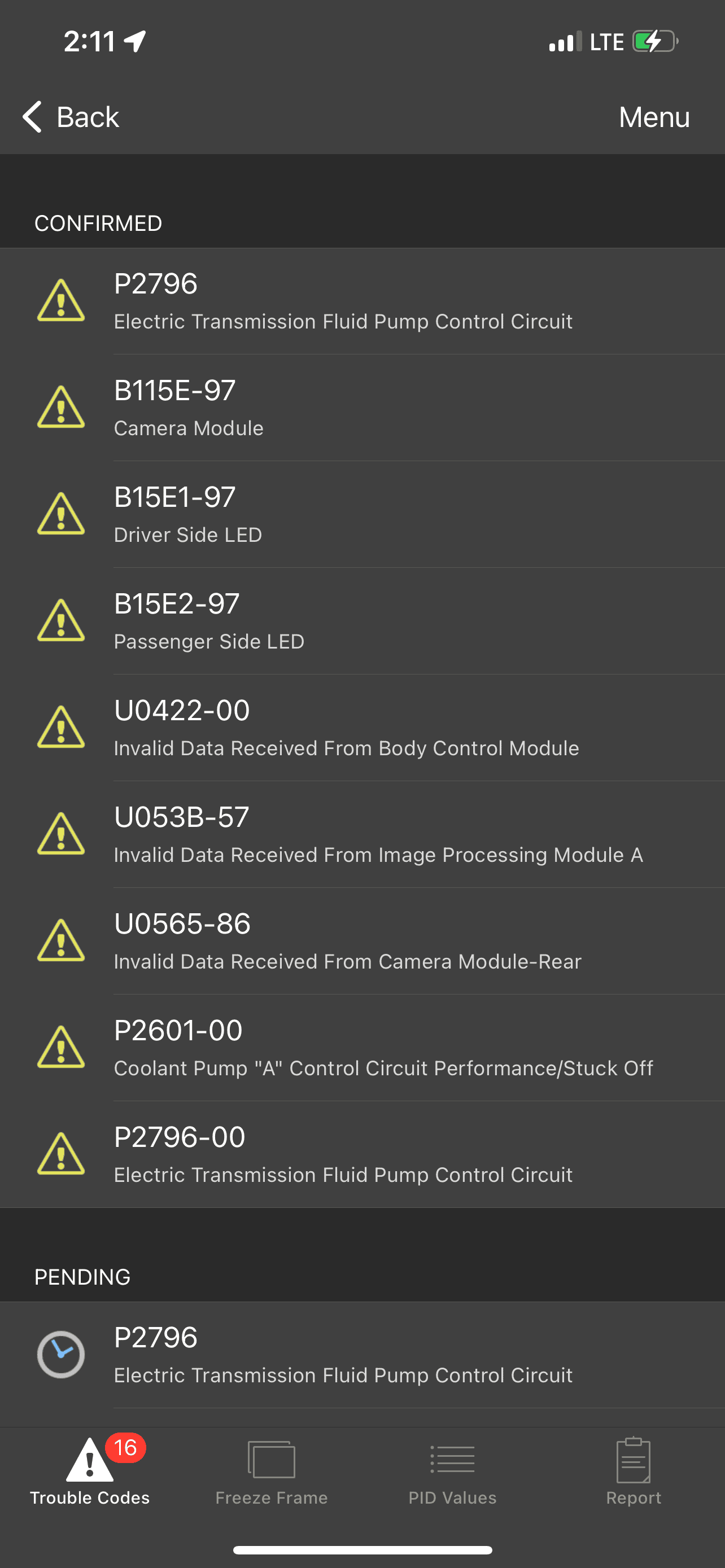

I spoke too early. I am getting 16 codes.
Ford F-150 Felt like I got hit from behind! IMG_7084
Ford F-150 Felt like I got hit from behind! IMG_7086
Ford F-150 Felt like I got hit from behind! IMG_7088

I am also suspicious of the 12V AGM battery. This morning the voltage was below 11.9V. At any rate, I will not be resetting the codes and will wait to see what the dealership has to say.
