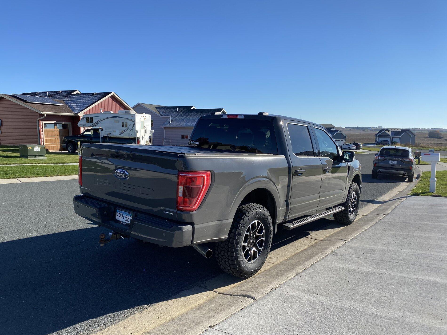

Mounted up a set of 35x12.50 Toyo Open Country AT III on the stock 18's. Very impressed with how they ride. Much better than my Nitto's ride. Of course it's a D rated tire vs's Nitto's E load.
I apologize these are not the best pics, truck is dirty.

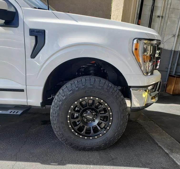

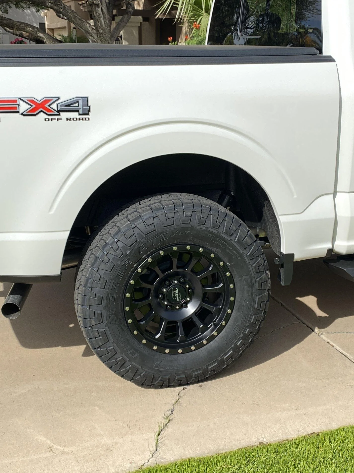

Here is a pic of 295/70-18’s and 0 offset rims, they fit great! Only had to trim the fairing about a 1/2”. Better proportion in my opinion than the 315’s (35’s) on 17’s like the raptor has.
