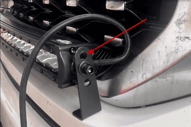

When setting up my bar on the valance, I noticed the rear of the lightbar hits the grill. Once installed this would cause wear on both the bar and grill, and it also prevents the bar from being properly aligned, as the contact with the grill stops the bar from being adjusted up and down (see pics).

And see what you are talking about there. Anyway you could wrap that area with some electrical tape or something where it would eat through the electrical tape before your shield?
Side note what is that body part called that you drilled the mounts to? I have thought about getting an exact same bar for my Platinum and having a backup replacement part in case I ever want to remove the light or sell the truck.

While electrical tape may help, it won’t eliminate the contact. The friction would still cause wear on the grill. Further, the contact prevents the lightbar from sitting level, so the concentrated light will be close to the front of the vehicle rather than out ahead.
F150LEDs call the part that the brackets mount to the valance.
i just may need to have some curved brackets made to allow the lightbar to sit out from the grill.

I see what you are saying. What happens if you mount the bar in that hole above? It looks like there are three holes total and you are in the middle hole? Can you mount it up to the top one to buy some space?

Using the top hole of the mounting bracket causes the back of the lightbar to hit the small silver ‘dashes’ in the grill. Using the lower holes causes the bar to hit the silver surround of the grill.
I question if F150LEDs actually tested this lightbar and mounts on a Platinum, because as can be seen, it is a poor fit.

Geeze, I have been looking for a lightbar for my Platinum since the day I bought it. I was hoping this might be it, but clearly its not and Im still apprehensive about drilling into that Valance thing. I am with you. I would take those brackets to a local machinist and have him create that bracket with holes half inch forward.

Hate to say.. he might be married to it now that he has drilled holes into body panels. His best bet is to go see a machinist and have them fab some new mounts like I showed above. I would do them in aluminum also to prevent any rust in the future.

I haven’t drilled any holes yet.
Unfortunately, returning the lightbar might not be economically viable because I’m in Australia, and F150LEDs won’t cover the return shipping.

Have you thought about getting some aluminum brackets machined?
