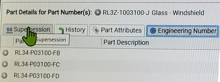

Carfreak, the number shown on the glass is not a part number, it is the engineering number. The part no. for my 2024 Lariat 502 windshield for a HUD is RL3Z-1003100-J. I assume that would be the part number for any 2024 F150 with a HUD. You can see from the screenshot below, there are 3 engineering numbers that could be on your windshield if you had a windshield installed that supports a HUD, with -FD being the latest engineering version.
The engineering number you showed on your windshield is incorrect if installed on an F150 with a HUD. I do not believe it is even the correct windshield for a MY24. The parts guy told me that the windshield for the 2024 F150 is a new design. I did confirm the engineering numbers are different for a 2023, supporting that the 2024s have a new design. Checking the dealer's lot, I saw at least 4 different windshield types for MY24 F-150s, e.g., RL34-P03100-A_, -B_, -C_, and -F_. When I researched this last October, the RL3Z-1003100-J part no. (RL34-P03100-F_) to support a HUD was not in stock with no date for availability.

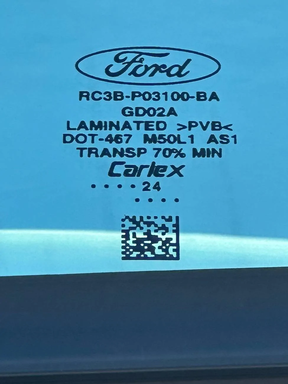

i believe this window is from a 24 F250. I have an appointment with Ford as this truck was delivered with this window installed. I found out that the window was replaced during transport. I was looking to confirm as i hate assuming something with no proof.
I believe the PN for the window currently installed is RC3Z1003100B.

My apologies i have a 24 F150 Lariat with the HUD. The PN you listed is the correct glass. I have had a double image since i bought the truck.

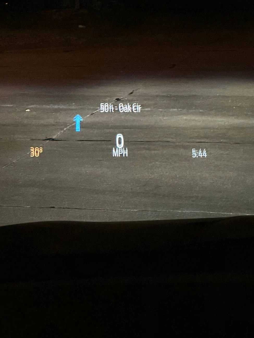

I have an appointment with the dealership on Wednesday to have it “inspected”. I will post pics of the double image later today
Ford F-150 F150 Windshield Replacement for MY2024 or later with Heads-up Display (HUD) IMG_2836

Wow, Carfreak! So sorry to see that double image. I've worked with HUDs for many years in the aviation industry and appreciate the challenges of presenting clear symbology to the user. I look forward to your update.

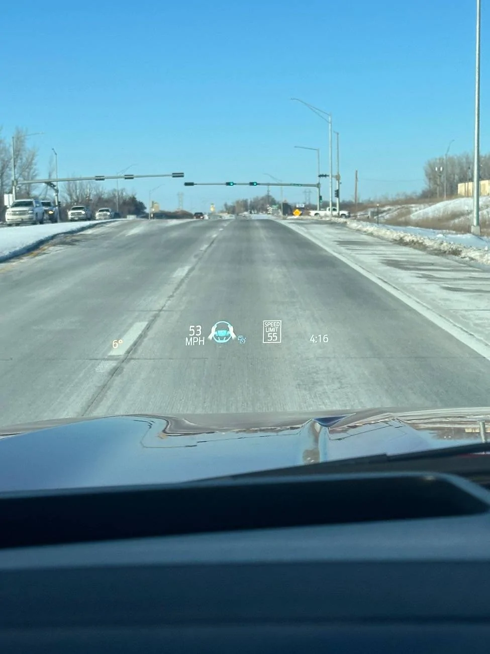

Ok update 19 Feb 2025. My dealership is telling me Ford Engineers are adamant its the right windshield previously installed. They did change it anyway and the HUD works as advertised. The wrong window was installed by a repair shop due to damage during shipment.
Ford F-150 F150 Windshield Replacement for MY2024 or later with Heads-up Display (HUD) IMG_2929

Carfreak, very happy for you. Thanks for posting your positive results.
