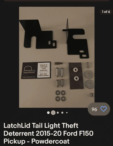

Interesting, LatchLid website says Ford fixed the TG release vulnerability on 2024s and their product is not needed.
