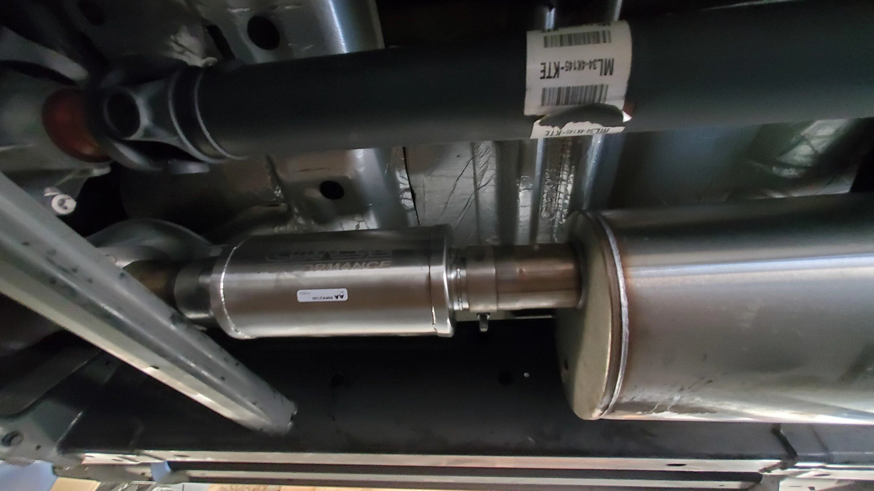

I recently installed a Corsa 21166BLK 3.0" single exhaust system on my truck. Out of the box I wouldn't call it loud, but at certain RPMs it did produce a frequency that resonated throughout the cab of my truck. Even when this occurred it didn't sound very loud, but the vibration was annoying. I decided to address this by installing one of their 10.75" case length packed resonators in front of the rear axle where the stock muffler is located; this made a massive difference, the strong vibration is gone, and my exhaust has a quieter and deeper tone now.

Quick question regarding the resonator you added: it's installed between the corsa muffler and the axle hump? Mind posting a couple of pics from below the truck?

That's exactly where I installed it. The resonator was a little long for this spot, so I trimmed about 1" off each end before welding it in place. There would have been tons of room if the flex pipe was a little further forward

Any particular reason you decided to mount the resonator after the muffler, rather than before?

Corsa mounts their muffler very far forward in the factory resonator location so going behind the muffler was my only option.
