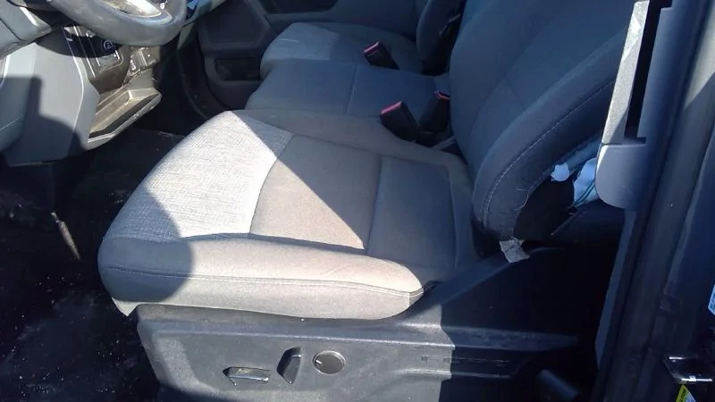

I have an XL with manual seats and I want to swap the driver's seat out for 10 way power.
In the picture below from car-part.com, a local junkyard has that seat. It's the same Medium Slate cloth as my XL currently.
To save myself effort in swapping the lower seat cover, can I just swap my current upper cloth cover and airbag onto the junkyard electric seat?
Ford F-150 Electric Seat Swap - Just upper cover? F150seat
yes
