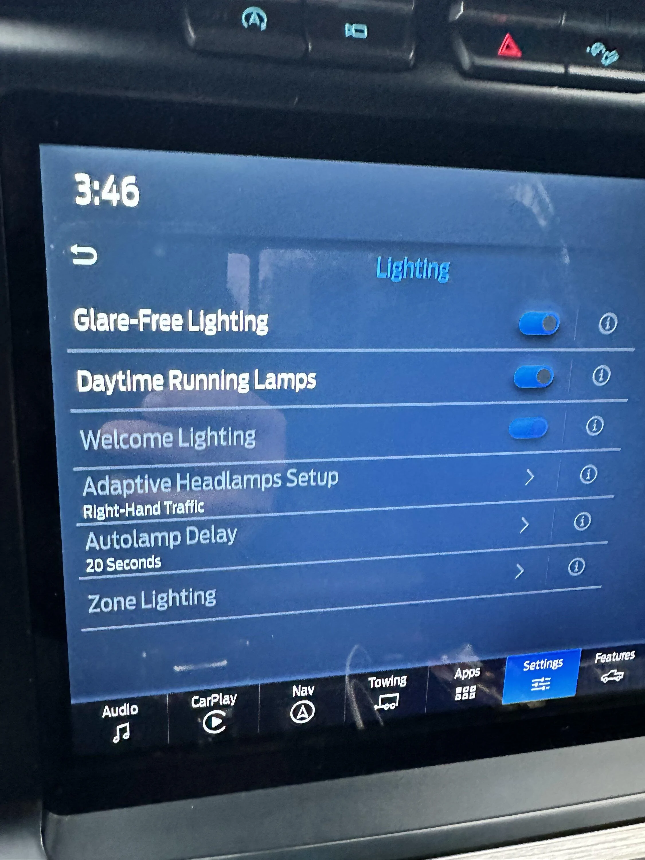

Anyone else have the option to turn off the DLR’s? No idea where this setting came from. It wasn’t there before.
