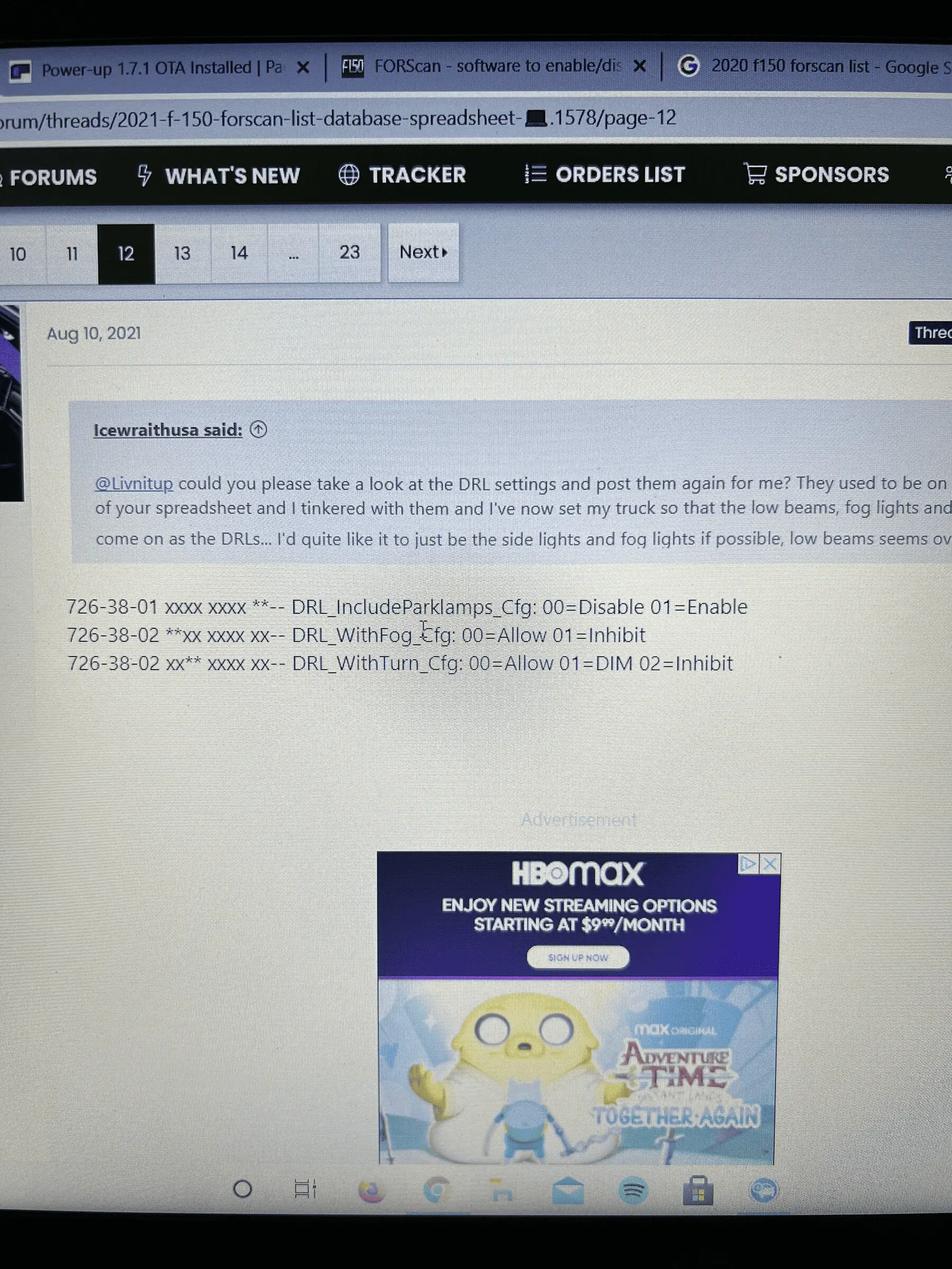

Thank you, Nightshade, ill try to do that. In the meantime is there a chance to set Light bar to be on in option 1 (off). my ideal set up will be to have option 1 (off) all the time and have led bar on in drive and manually switch to option 3(auto) when it gets darker to have low beams + led bar.
and im trying to make sense of these codes:
first one is put rear light with DRL
second keep fogs with drl
what is 3rd one do?
