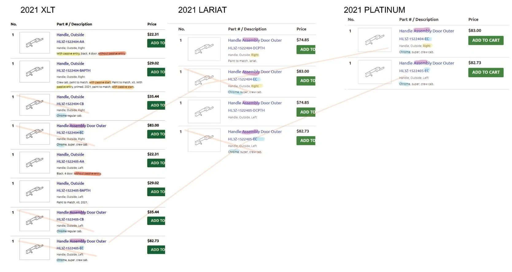

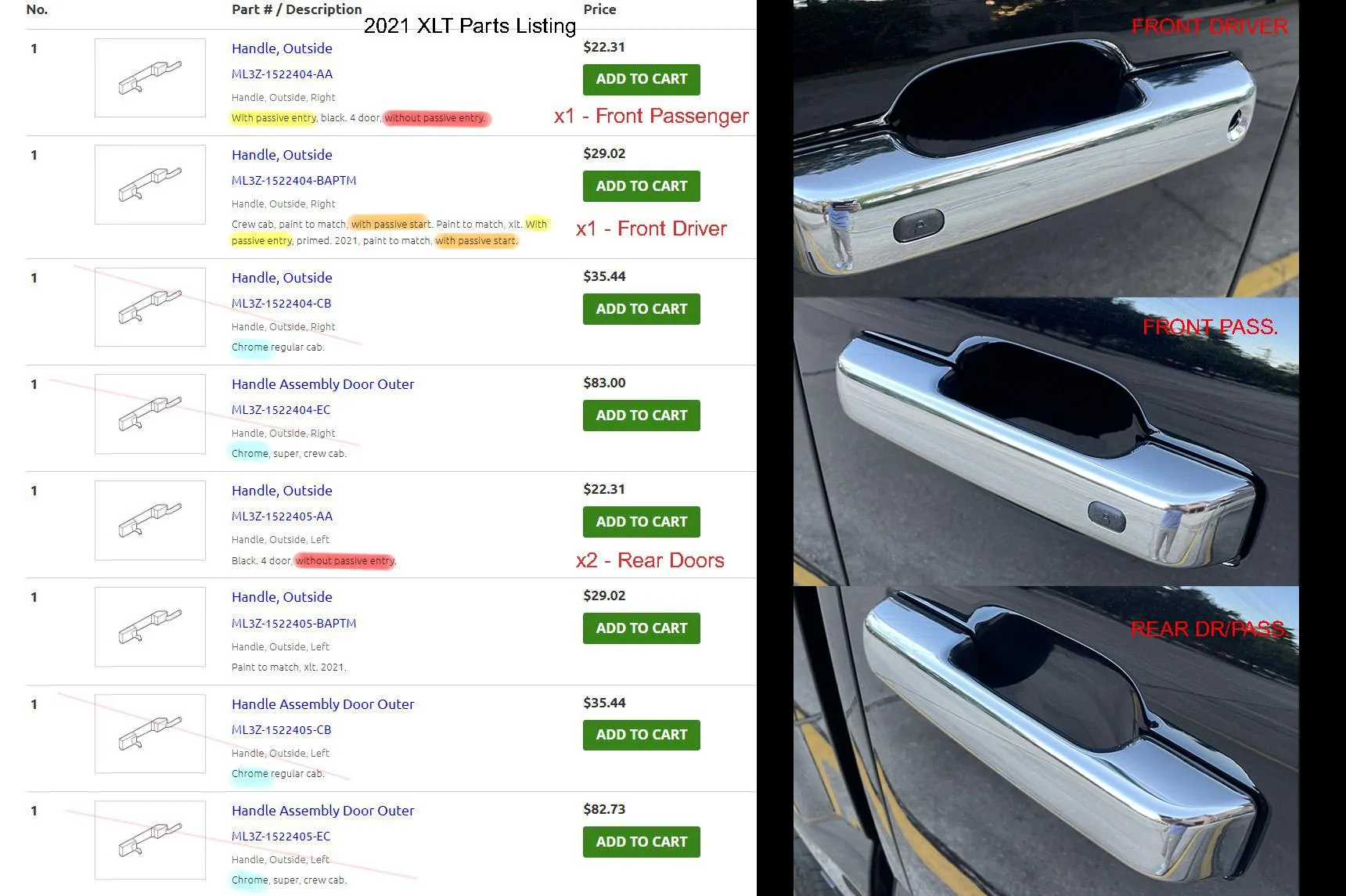

Looking at Tasca Parts and similar. No parts for 2022 model, but appears from other’s post, 2021 fits. I compared XLT, Lariat, and Platinum parts listings to try and figure this out by process of elimination, but I'm struggling on what four handles I need for Platinum SuperCrew Cab...
OEM Parts stores and Ebay have conflicting descriptions for whether right/left is passenger/driver…
Parts listed with "passive entry" and "passive start" - neither makes sense in my mind for which one is the push-to-lock
FFS, has anyone ordered replacements and can confirm the 3-4 different handle part numbers?

Left should be drivers side, right is passenger side. If your exterior handle just has key hole ,it will show w/o touch open option. The passenger side wont have a keyhole. Another way to solve you dilema is to find a truck with the door handles like you want,then order by VIN on that vechicle

I’d suggest you call the eBay vendor who buys the OEM handles and paints them in the factory color of your choice. They don’t come painted from Ford, they are primed with PTM (paint to match) part number endings.
Essentially it’s either a smartkey handle or not up front. He can help sort that for you versus trying to make sense of the errant ford parts lookup systems that are public facing.
Be advised, the front ones with smart key are needlessly expensive. Retail approximately 130, online approx 75. Need to factor that to make sense of them charging $400 for a set of painted handle covers.

Assuming your Platinum is keyless entry, the part number for the front doors should be:
ML3Z-1522405-DBPTM (drivers side)
ML3Z-1522404-DBPTM
I bought a drivers side @ $77 online. The rears are quite a bit less, but didn’t get those numbers as mine came painted so not swapping all. I contacted BFN about painting it in case I don’t have it done locally or luck into one on eBay.

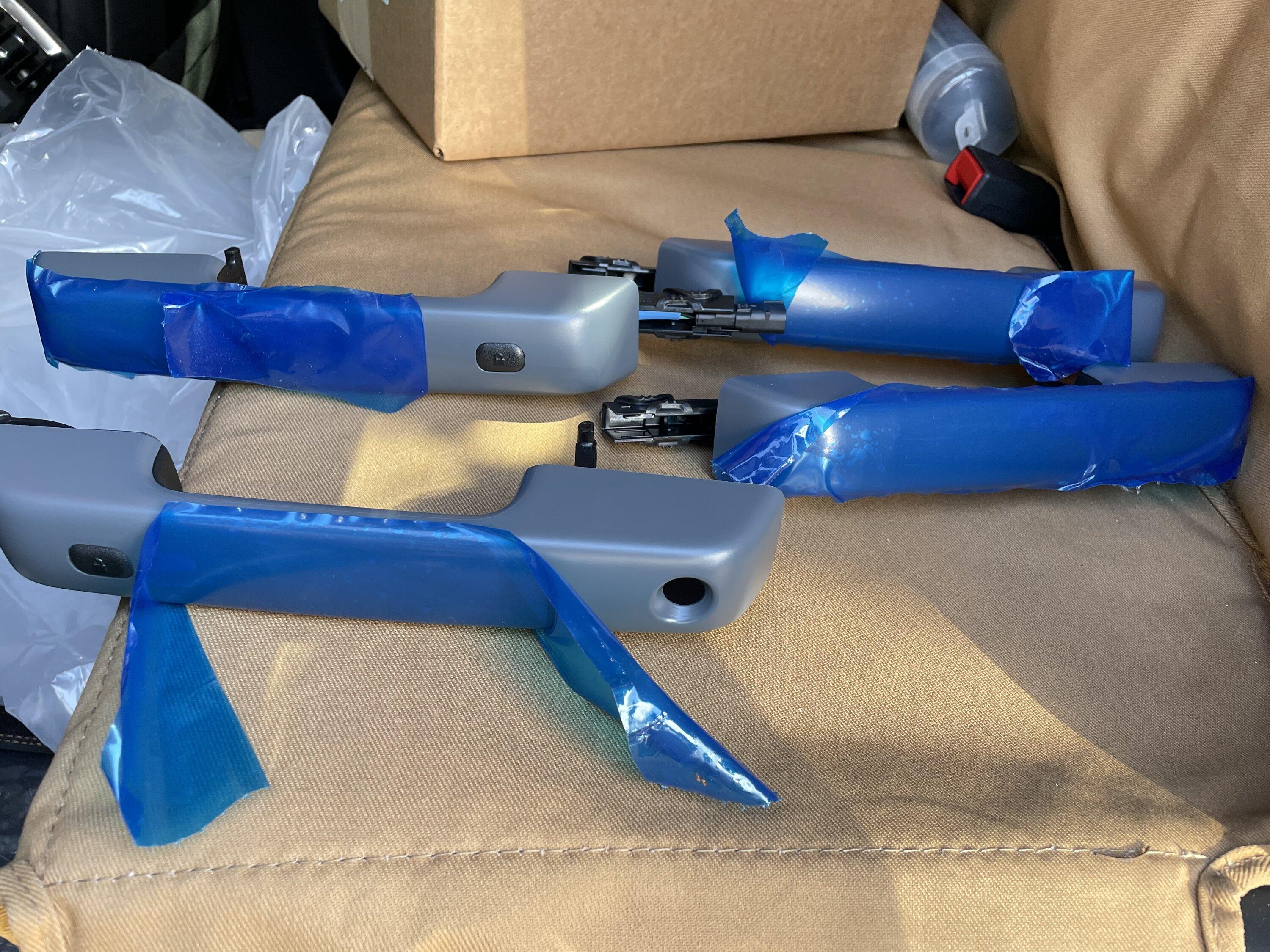

Update: Received parts from Tasca, took about 20 days order to delivery. I have not installed them but at first look it seems these are the correct parts numbers for door handles. Mirror covers included also
Part Number​
Part Name​
Price​
Quantity​
Total​
ML3Z-1522404-BAPTM​
Handle, Outside​
$29.02​
2​
$58.04​
ML3Z-17D742-DAPTM​
Mirror Cover​
$44.63​
1​
$44.63​
ML3Z-17D743-DAPTM​
Mirror Cover​
$44.63​
1​
$44.63​
ML3Z-1522405-DCPTM​
Handle Assembly Door Outer​
$74.85​
1​
$74.85​
ML3Z-1522404-DCPTM​
$74.85​
1​
$74.85​

Unfortunately...I guess the $75 makes sense at that point. Just need to find time to paint now.

Unfortunately not yet. Handles and mirror covers still sitting under my desk ATM...
