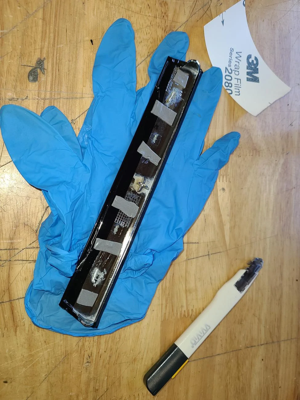

At this point, you'll see the handle is held on with two clips. Release clips with a screwdriver.
Grab a non marking tool and pry the chrome cover from the bezel. There are 5 drops of glue holding it on besides the clips.
Reassemble in reverse.
My clips broke despite the effort so I will use 3M tape to reattach it after I wrap it.
