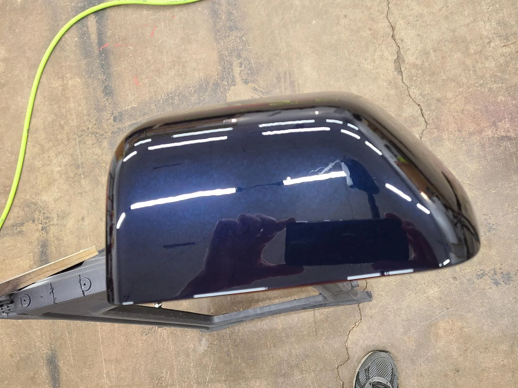

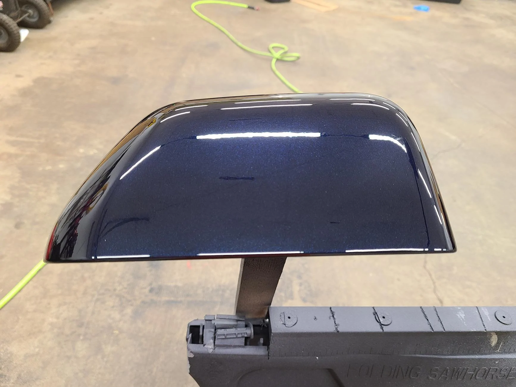

Speaking of painting...
Ford F-150 Removing chrome coating from plastic... 1000003483
Ford F-150 Removing chrome coating from plastic... 1000003482
