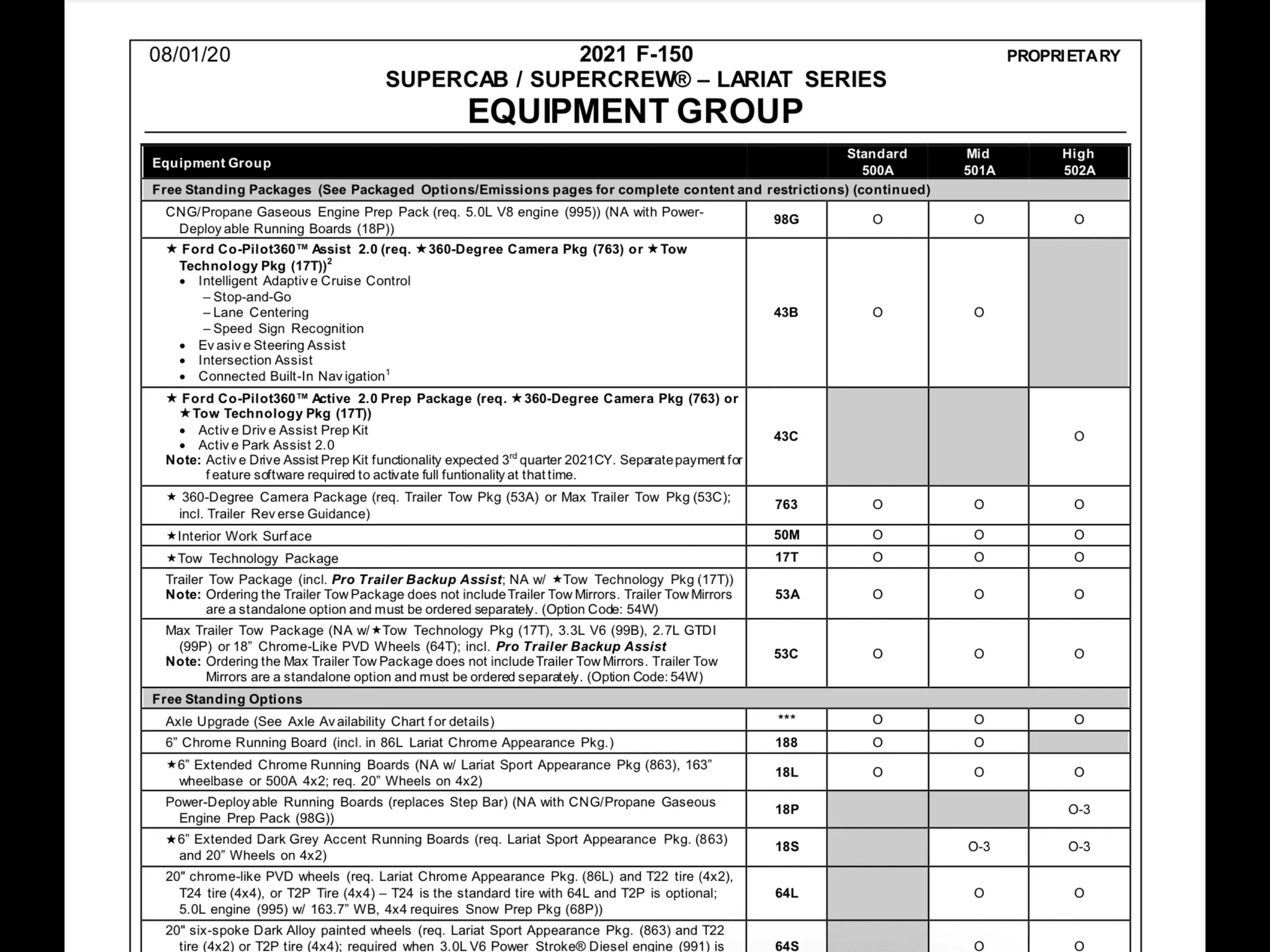

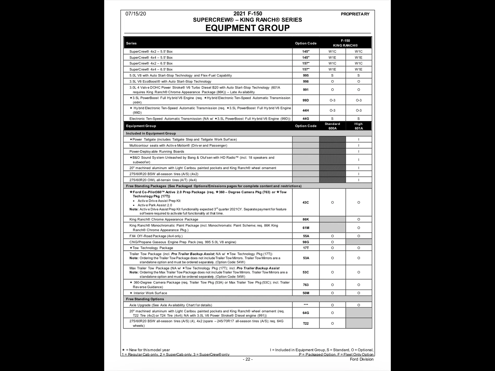

basically, if you have to pay for the assist 2.0 then it comes with the sensors. If you don't because it is included with a package (like Lariat 502a for example) then you have to pay for the prep 2.0 to get the sensors. So Lariat 501a gets sensors with assist 2.0, xlt 302a as well. Lariat 502a and higher come standard with assist 2.0 so you need to buy the prep 2.0 to get them. Really dumb
How true. I was wrong in my above post. On the Lariat, there are two packages, a 43B and a 43C. I wanted the front sensors on my KR order, but had to add the prep since the only option is 43C. Why not a 43B.

I ordered my 501a pkg with co-pilot 360 assist 2.0 which cost $750 and $765 for 360-degree camera package. My truck has the front sensors on the bumper. Don't know why ford just doesn't just put these on of all trucks, hard to see how close you are to something with out the use cameras.
I ordered the same setup and I’m glad to hear that as the way I had interpreted the order guide it would have them.

I also have a 21 F150 King Ranch with practically everything to include the assist 2.0. The Active Prep option was the only option I didn’t have. I ensured I researched and the selections it had included everything I wanted. What pisses me off is the 21 F150 brochure and order guide calls out the Forward Sensing System and rain sensing wipers as included under the Assist 2.0 package, not the Active Prep package. That tells me the lack of sensors are a mistake. Similar to not programming my truck with its as built configuration before shipping to the dealer.

I ordered mine back last Aug and I can tell you it was real confusing on this issue.
I wanted the forward sensors and thought I was getting them. I did not want to pay $1,000 for it though, for I was not interested in auto drive. My current drive assist is plenty good enough for me, just would have liked to had the front parking sensors.

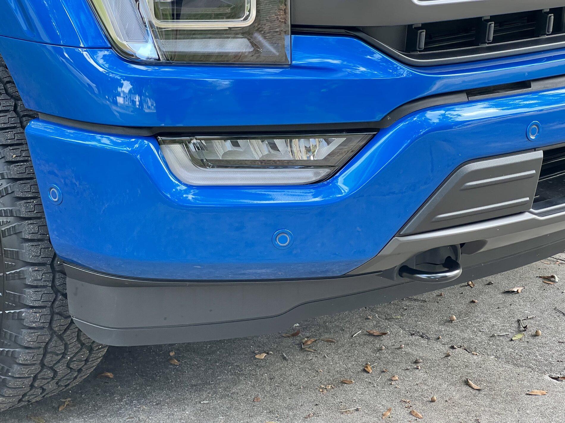

Hi, I just bought a 2021 f150 lariat 502a, and I have no front parking sensors, but some XLT trims have them. are they hidden at all in the bumper? If not, this is dumb.
Front sensors look just like rear sensors. They are not hidden.

I acknowledge what the brochure says. The brochure was also what i used when ordering my 21 KR with the Assist 2.0 which at the time (Apr 21) stated that the forward sensing system was include with the assist 2.0. However, when i received my KR i noticed it did not have the forward sensing system. Afterwards, around May 21, the brochure was updated to reflect that the forward sensing system was only included under the active prep package on the Lariat High+.
I included the link on purpose though. The KR i linked only has the assist 2.0; however, if you look at the pictures, you’ll notice it also has the forward sensing system. I also saw a tremor high with only the assist 2.0 which also had the forward sensors. Since then, i have begun seeing that the 2022 Lariat High, KR, and Platinums with the assist 2.0, all have forward sensors on their pictures. The brochure just hasn’t caught up, once again. Look up a few Lariat High+ 22 F150s with only the assist 2.0 and then check their pictures. You’ll see what i see.
