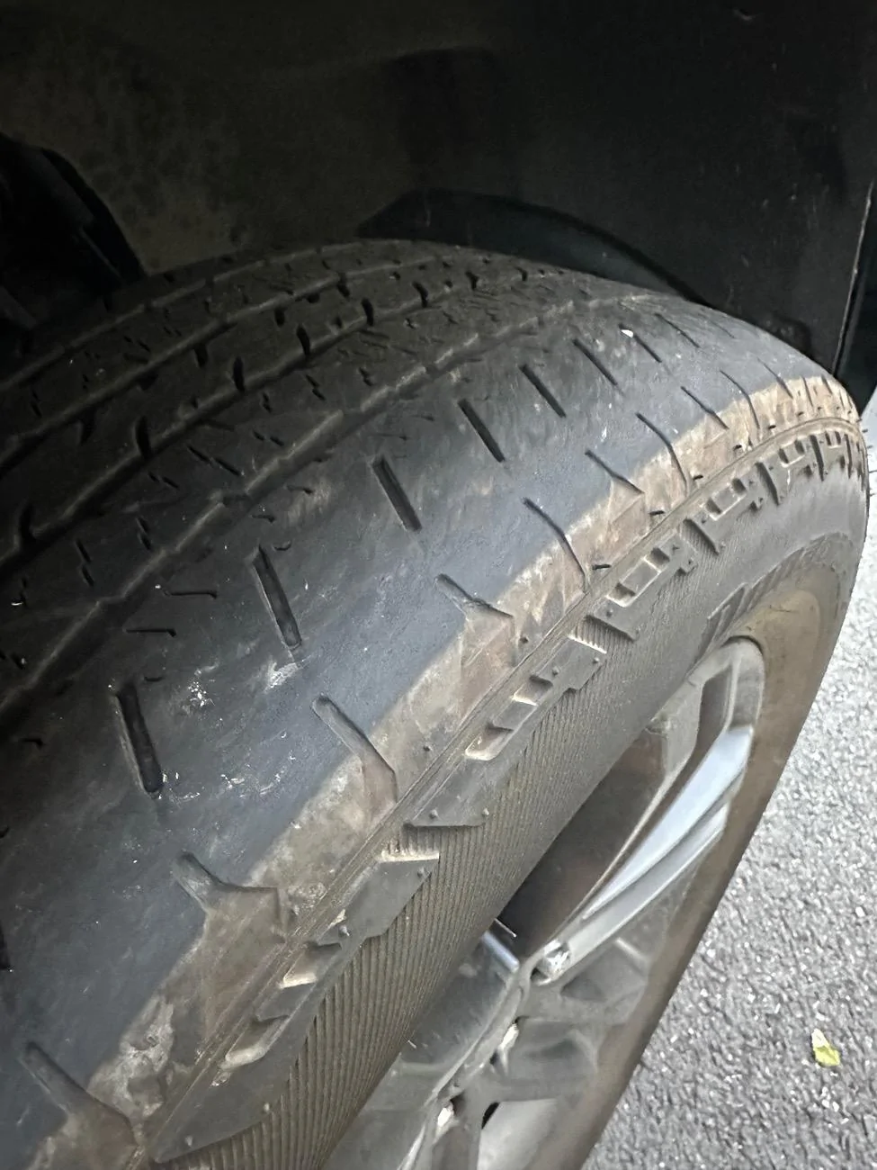

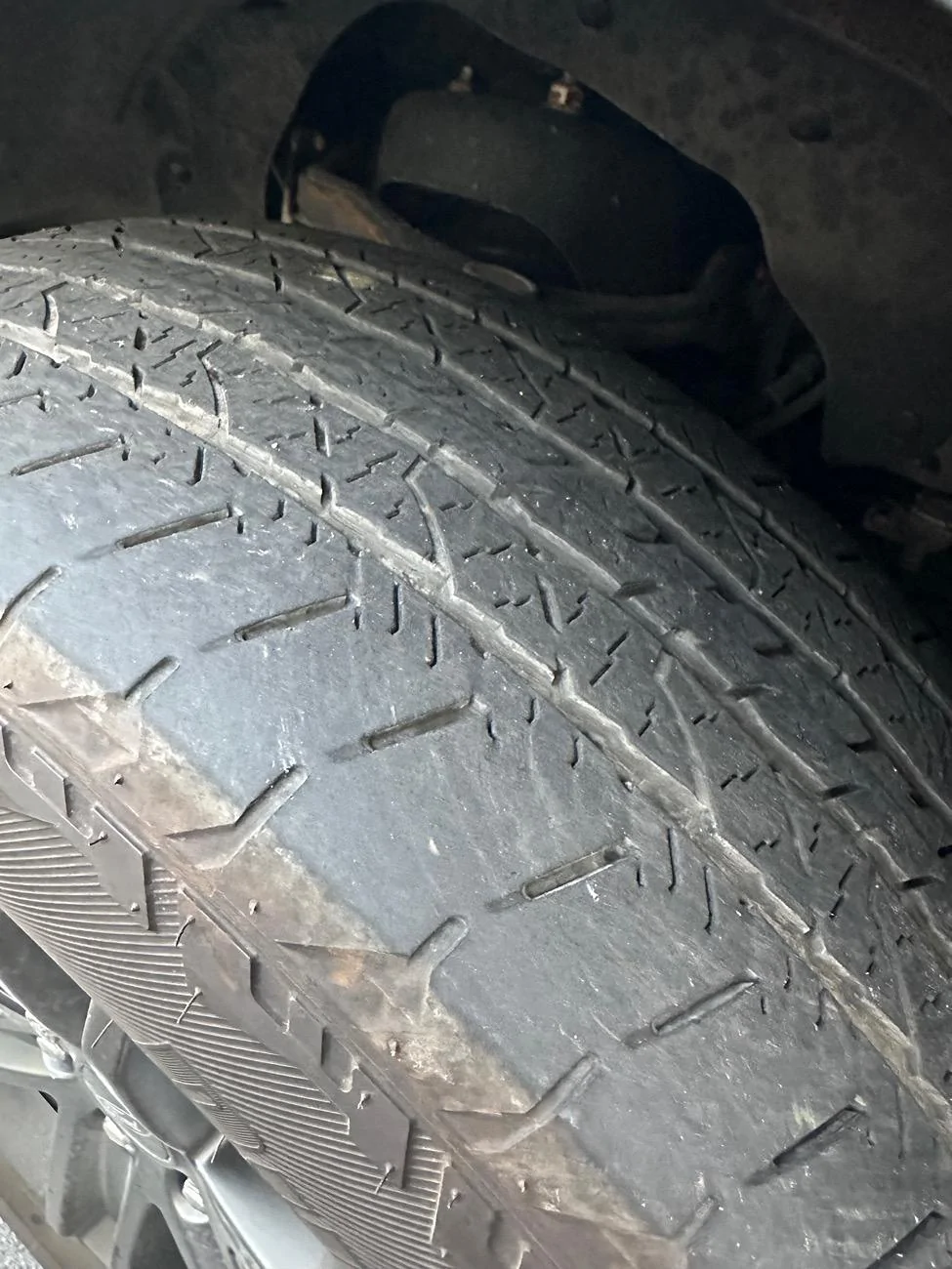

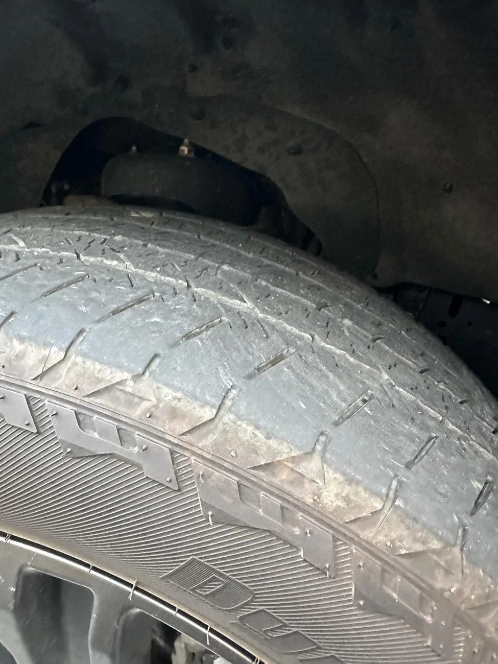

Garbage OEM hankook dynapro’s that everyone complains about with outer tread wear. Been fighting it since new. My Blizzaks don’t wear like this in the winter. I’ve run it 38-40 PSI fairly consistently and not much left. I’ve had alignments. I’d say the main tread is at least double the wear bar height, maybe even 3mm above. Are the outer treads too worn? I have a 200mi highway trip tomorrow with a jet ski to tow. Might just take my Yukon ffs.
First and 3rd pics are driver front. Middle pic is passenger front.

I would definitely recommend replacing them sooner rather than later…
that being said, I have run worse tires on much longer trips. Not recommending it but if it were mine, I would be ok running them on the trip then replacing when I get back.

Replace the tires
Get an alignment
ROTATE tires MUCH more often

Single sided tread wear is an alignment issue. Both side tread wear is under inflation. Whoever did the alignment screwed it up. ...And if your get down to the wear bars... Even if only on that side... you must replace the tires.

What do your rear tires look like? I would assume they are not as worn as the front?
