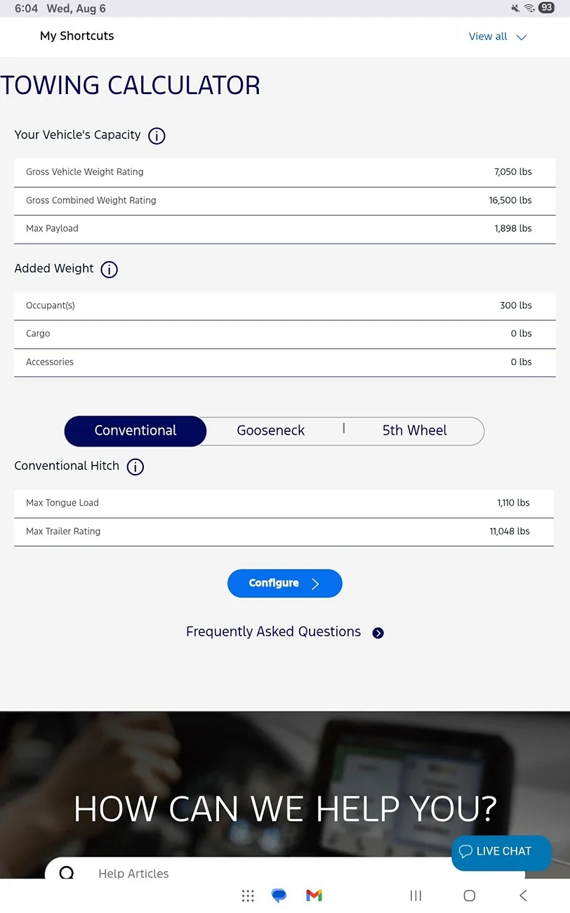

This is my towing numbers according to Ford. With a WDH I can go to 11,048 lbs. That's with only 1 person and the box is empty. I don't have max tow, just tow teck.
Ford F-150 Do I have the Tow Package or just Trailer Tow Technology? Screenshot_20250806_060401_Chrom

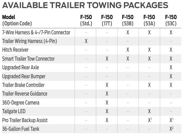

I think you guys are wrong if you're saying that the only way to go above 7,000 lbs is by installing an upgraded front sway bar, upgraded cooling, upgraded rear axle, etc. The Ford towing guide says you can go to 9,100 or higher with the PowerBoost with simply the 53A package, versus the basic 53B package. The only stated additions with the 53A package are 1) TBC, 2) Tailgate LED and 3) Pro Trailer Backup Assist. Obviously 2 and 3 have nothing to do with the physical ability of the truck to pull a load. So this tells me you can go from 7k to 9k just by installing a TBC. It's the heavy-duty 53C package that adds upgraded rear axles and bumpers, which gets you about 10% higher GCWR.
Ford F-150 Do I have the Tow Package or just Trailer Tow Technology? 1754491340286-xa

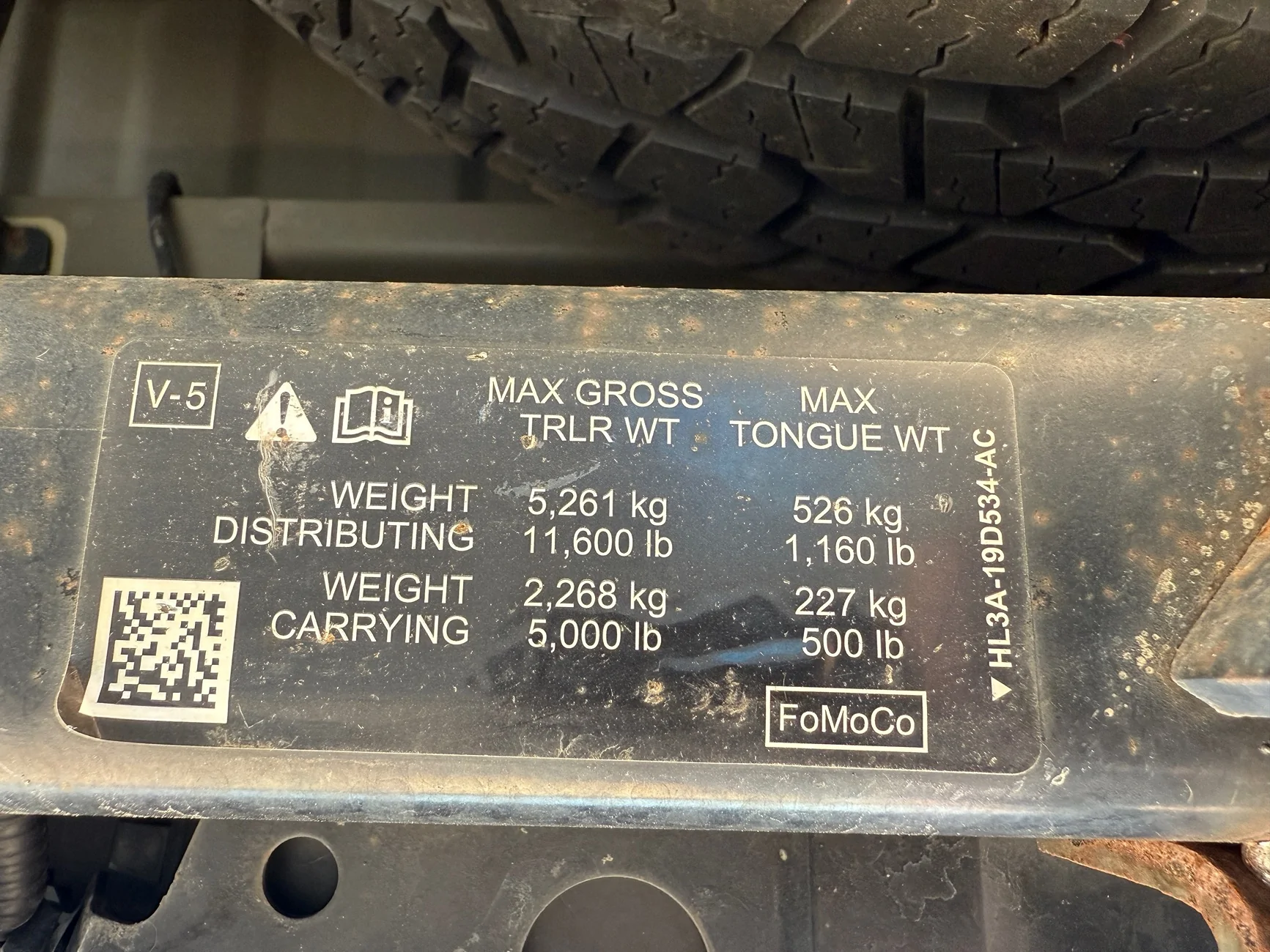

just to throw another monkey wrench into the discussion, I went and checked my hitch just to see what it says.
V-5 hitch with 11,600 lb weight distributing. So at this point I'm not even sure Ford knows :cwl:
Ford F-150 Do I have the Tow Package or just Trailer Tow Technology? IMG_3780

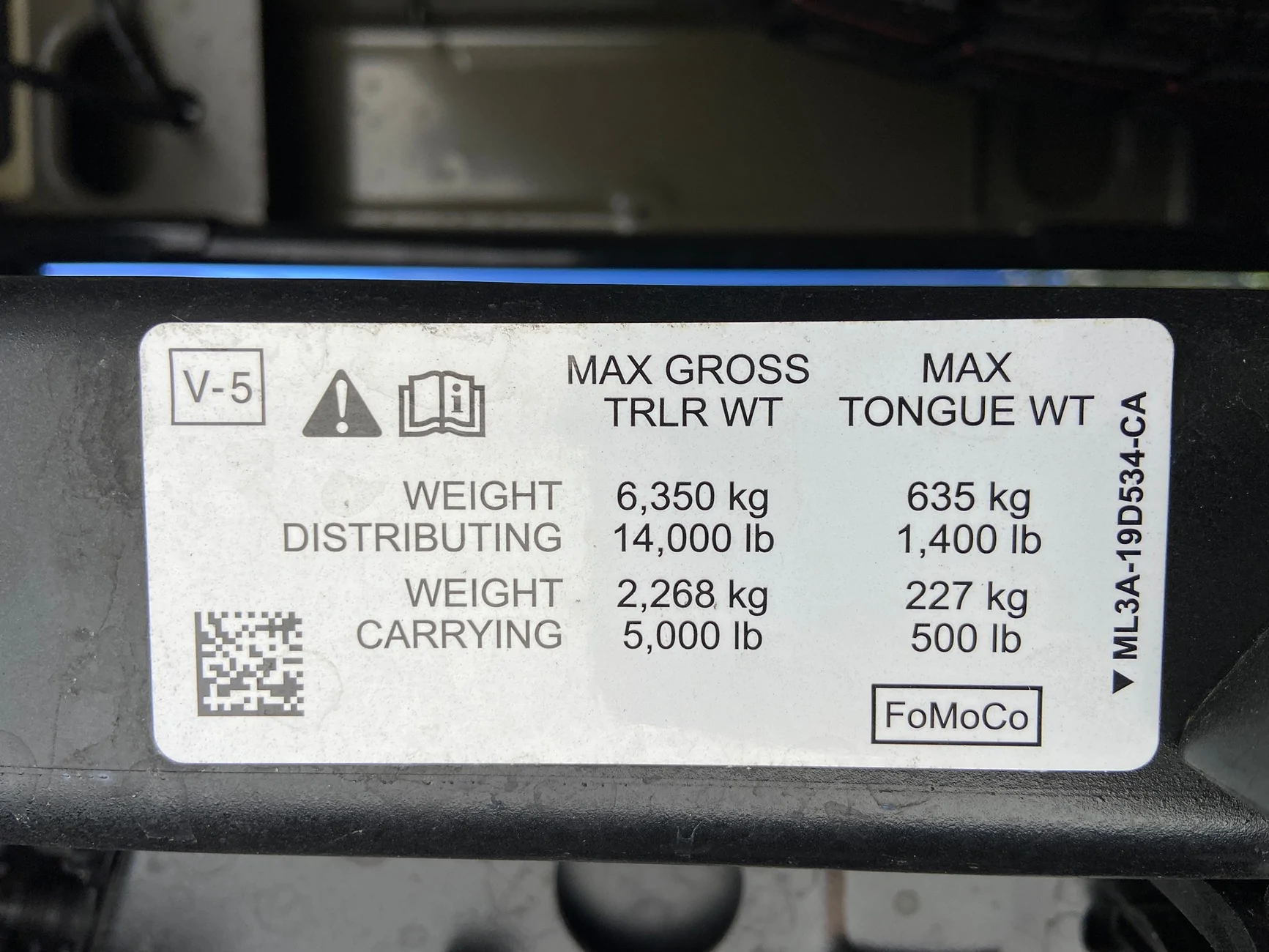

Here is my Hitch info. I have the max tow package 53C options on my 2021 PB Platinum to compare.
Ford F-150 Do I have the Tow Package or just Trailer Tow Technology? 1754496659908-vj
