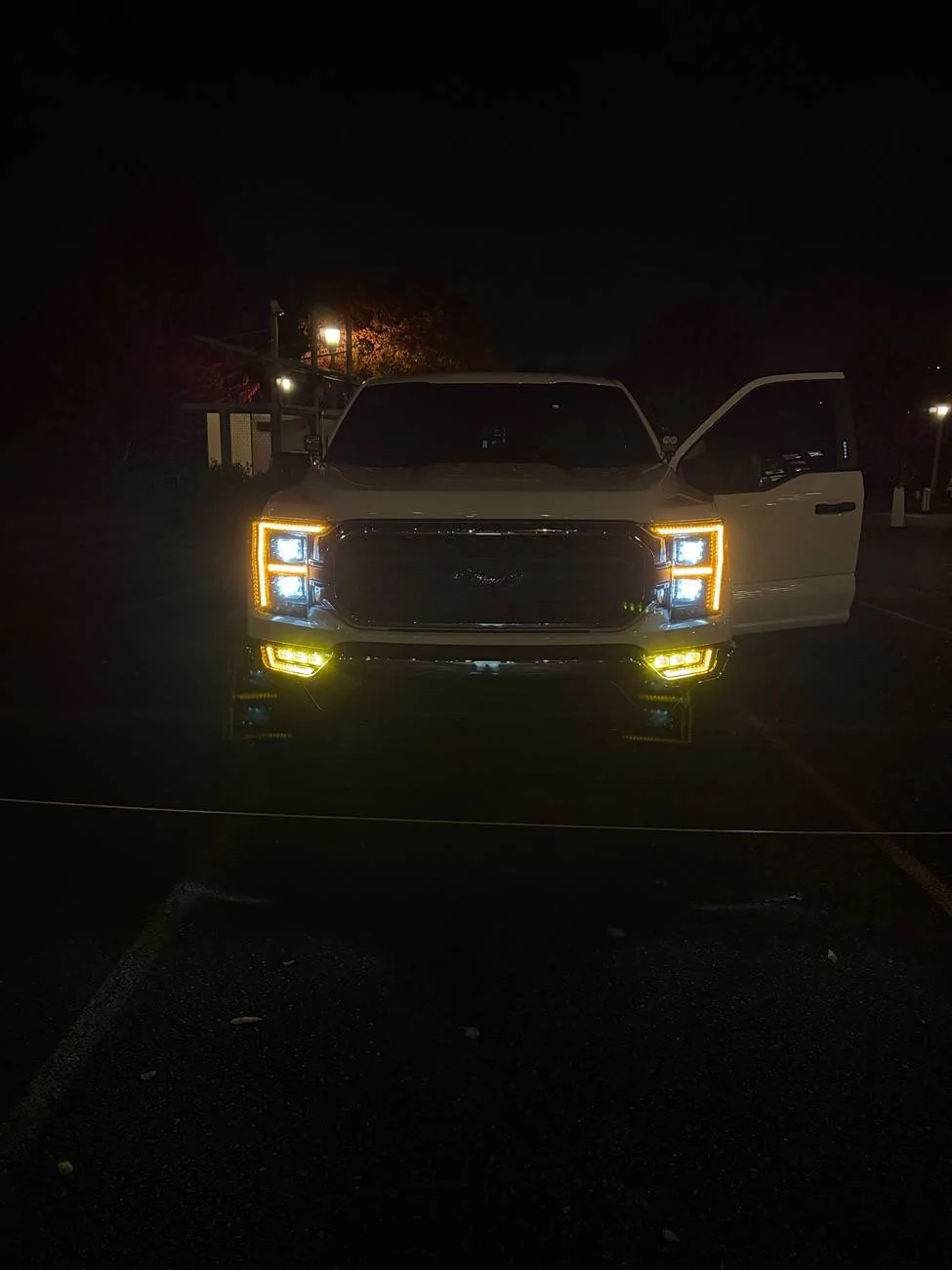

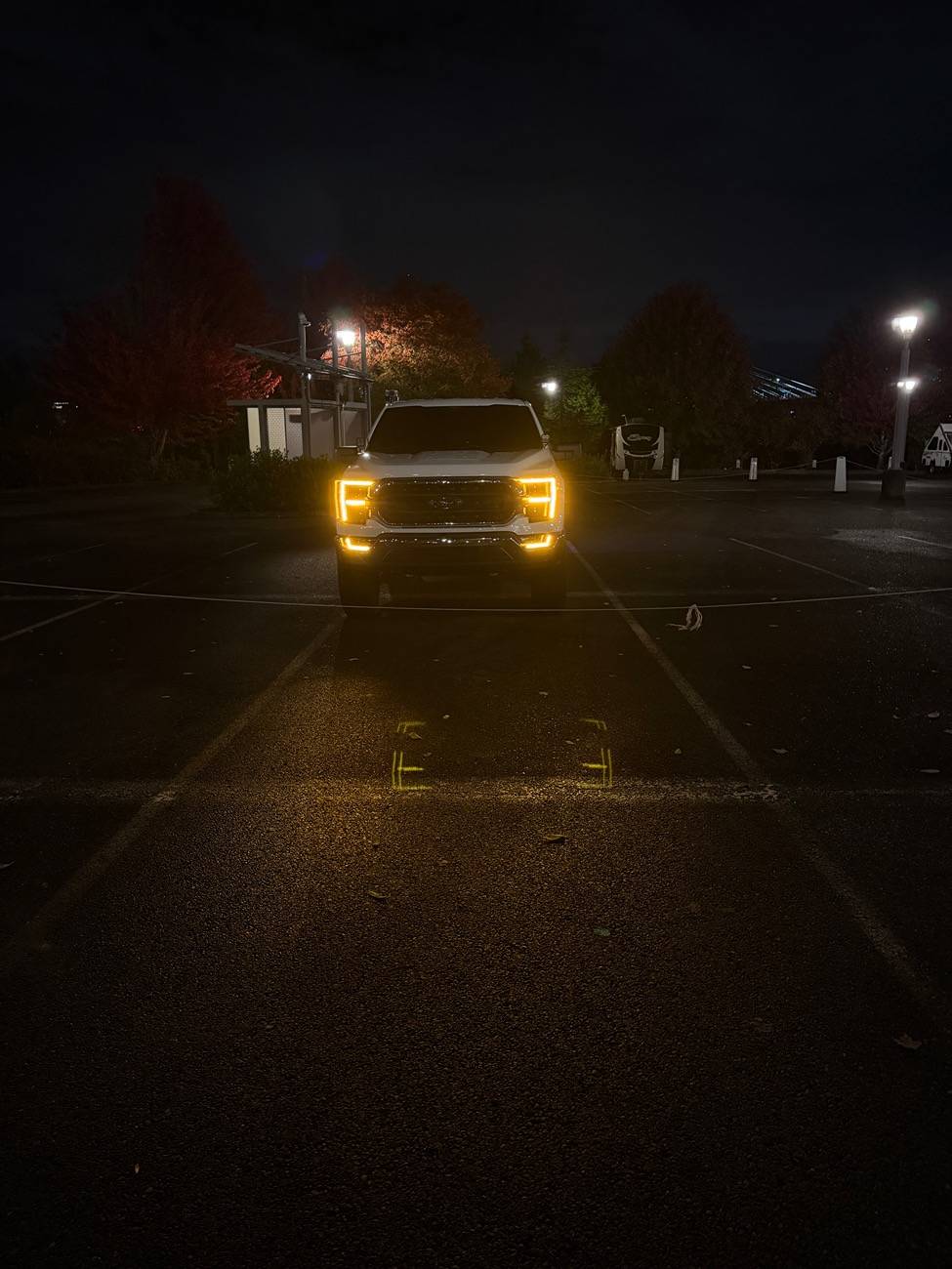

The headlights are beautiful, but is it safe to assume if one wants a seamless experience, perhaps go to Morimoto? Looks like there are still kinks that need to be resolved?
Honestly- now that theyre dialed in, I wouldn’t spend money on anything else. I’m a bit pissed that they held onto my money for so long but the product is phenomenal. They look awesome and perform even better.
