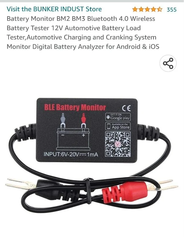

I have this issue every couple of weeks even though I drive about 1 - 1.5 hours per day at least 5 days per week. I’ve installed a Bluetooth battery monitor that Mr Snakebitten recommended and it seems the battery just gradually runs down over two weeks.
I thought that the battery may be bad. I’ve topped it off twice and load tested it right after…. It passed just fine. Then I sat there monitoring the voltage after a load test…. Looks like the batter is fine as far as testing is concerned.
I have seen folks talking about Fords BMS algorithm not being aggressive enough in terms of charging the 12v battery. I must agree. I feel like when I get going every morning the truck will pump ~14.5v to the battery for just a few minutes and then just drop down to ~13v. I know you can alter the SOC goal via FORSCAN from Fords default of 80%? To 90%, but I am afraid of doing it.
I've posted it on a few threads, but for $20 you can know beyond a doubt what is going on with your battery.
24/7/365 logging and you don't even have to wake the truck up to see what's going on. You can view what happened last night while you were asleep. :)
Ford F-150 "Deep Sleep" Screenshot_20230419_105615_Amazon Shopping
Battery Monitor BM2 BM3 Bluetooth 4.0 Wireless Battery Tester 12V Automotive Battery Load Tester,Automotive Charging and Cranking System Monitor Digital Battery Analyzer for Android & iOS https://a.co/d/aPktN4X
The smartphone app connects to it and as mentioned previously, it doesn't wake the truck. And then the app downloads the log so you can view up to 7 days of battery SOC
