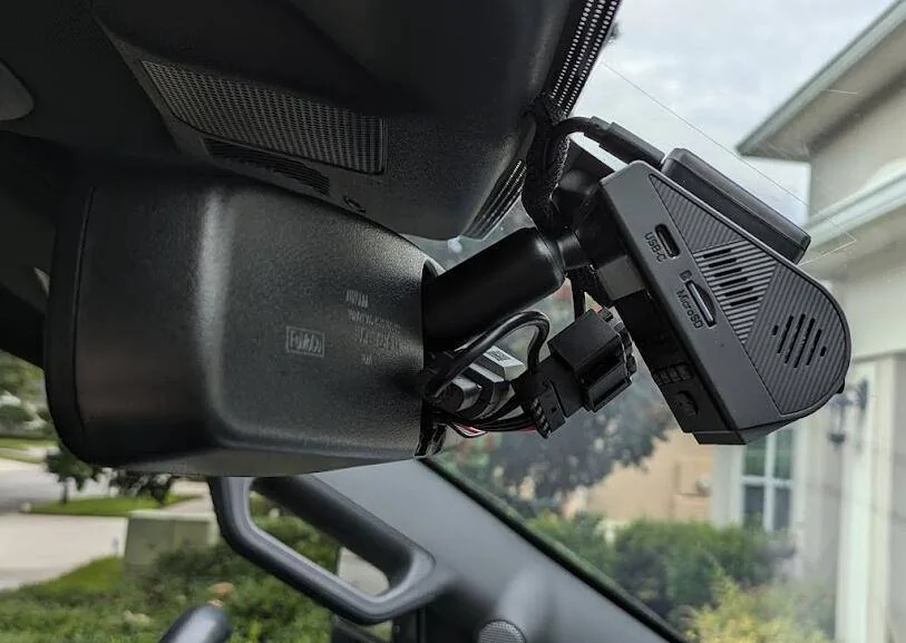

Just be aware that the power from the mirror is only on when the vehicle is on. If you have a camera that has the ability to monitor motion when the vehicle is off the Dongar adapter will probably not allow this feature.

I did use a wiretap into the rear view mirror auto-dim plug for my radar detector, but that doesn't draw much and it doesn't need to run after the truck is shut down.
