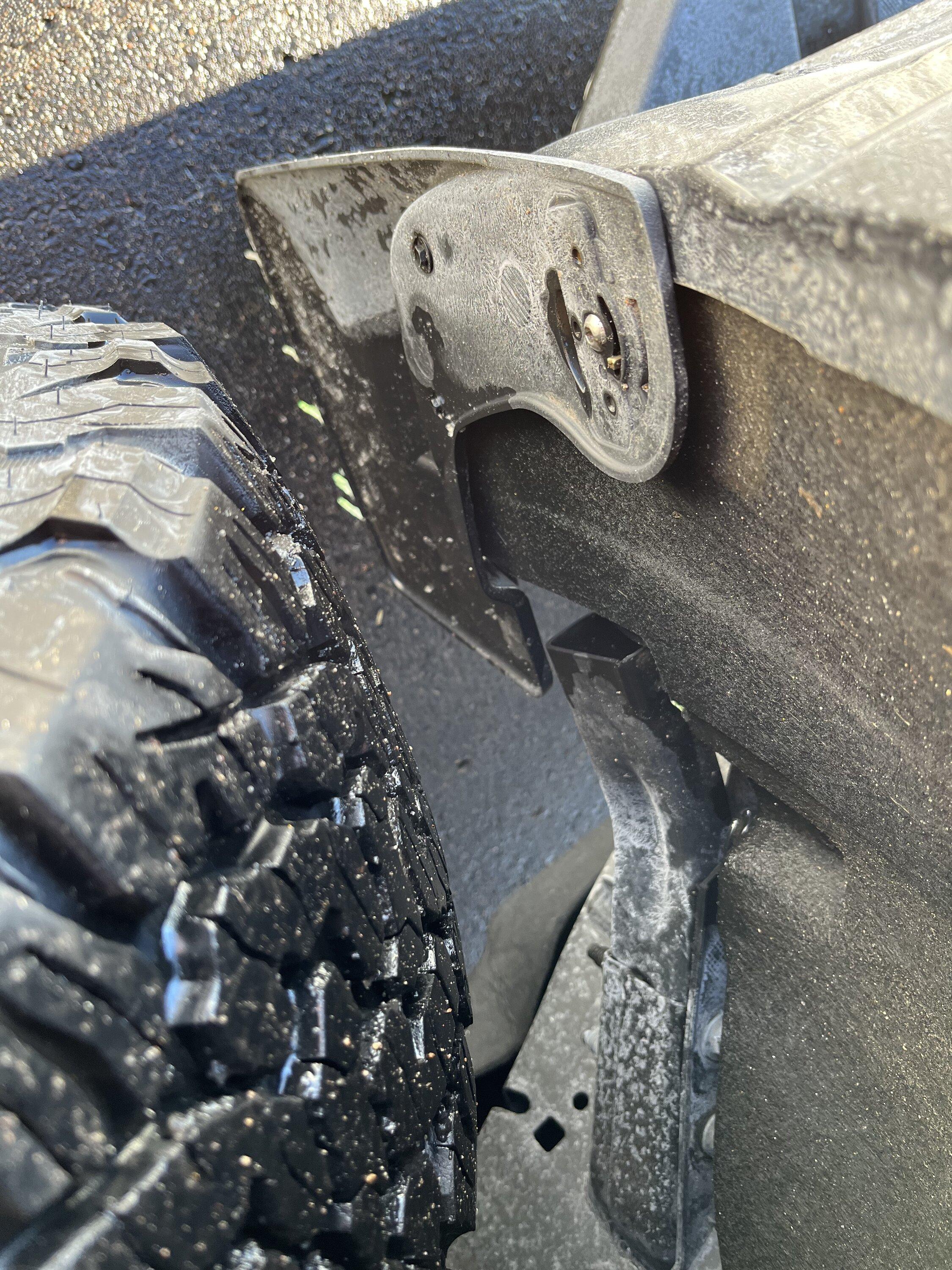

So twice now after a touchless car wash I see coolant dripping from behind both front wheel wells. Anyone else have this?
1st occurrence the truck idled during the wash. 2nd occurrence I had the truck shutoff during the wash.
nothing is getting hot. Can’t seem to find where it might be coming from…
+photo. Seems to run down the back of the inner fender and down the crash bar…both sides

How do you know its coolant?
Have you check your coolant overflow reservoir level before and after?

That's where the cowl drains from. Chances are that's just soap or wax. Grab a water hose or bucket and pour water in the pockets under the wipers and watch, you will see the majority of it come out right there.

These trucks hold water in auto washes. I bring mine home and if I need to pull into the garage right away, I end up with a good sized puddle on the garage floor under the engine. If I can, I park outside for an hour or so to let it drip in the driveway.

I have noticed the same thing. Take it to the car wash at lunchtime and drive back to the office some 5 miles away. Come out a few hours later and there's almost always damp spots/puddles under the truck under the front fender area like OP showed.

Be lucky you don’t have the BAP/Tremor hood with the fake vents. Those vents are water reservoirs. I was surprised the first time I washed my truck. Damn.

Thanks guys, It is most likely just 'green soap/water' I didn't even consider that...and my sense of smell isn't the greatest, so I couldn't ever tell if what was dripping was actually coolant, just looked like it.
