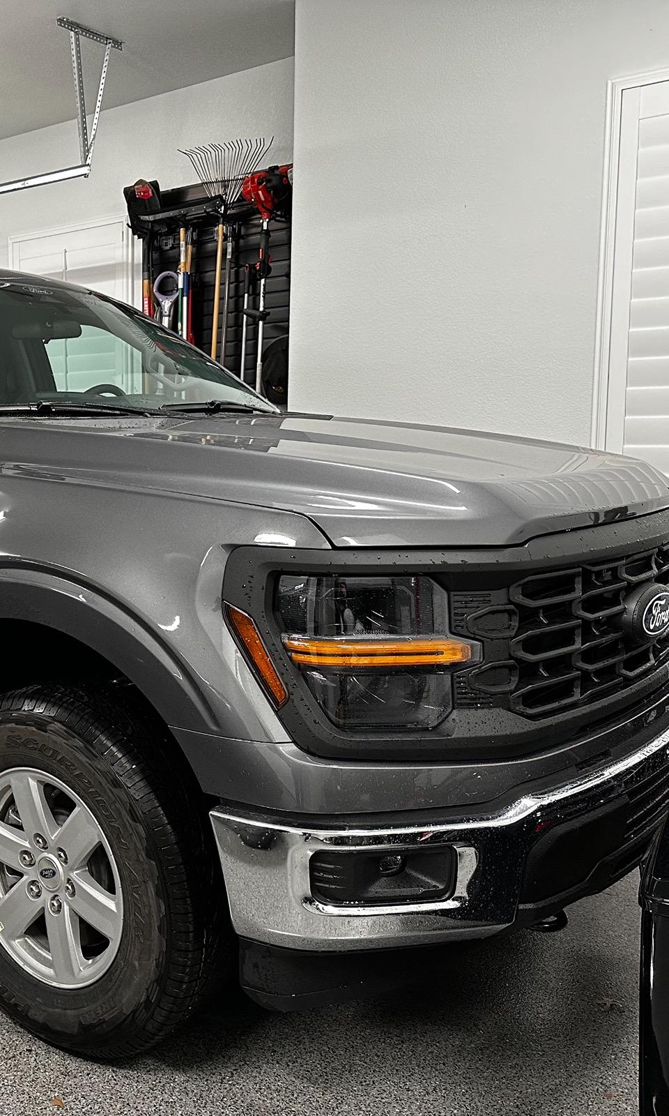

Been curious to see what type of conversion would be possible on the new front ends. For those interested, it looks like you can upgrade the lower trims to the Lariat front end without having to change the hood. The hood appears to be the same on the Lariat. The trims above Lariat look to have a different hoods.
The fitment of the grille for XL, STX and XLT on the sides where the grille lines up with the front fenders has been less than stellar from what I’ve seen. Mine and multiple others I’ve seen on lots. The gaps aren’t the cleanest and just don’t line up that great. Anyone else seen that?
