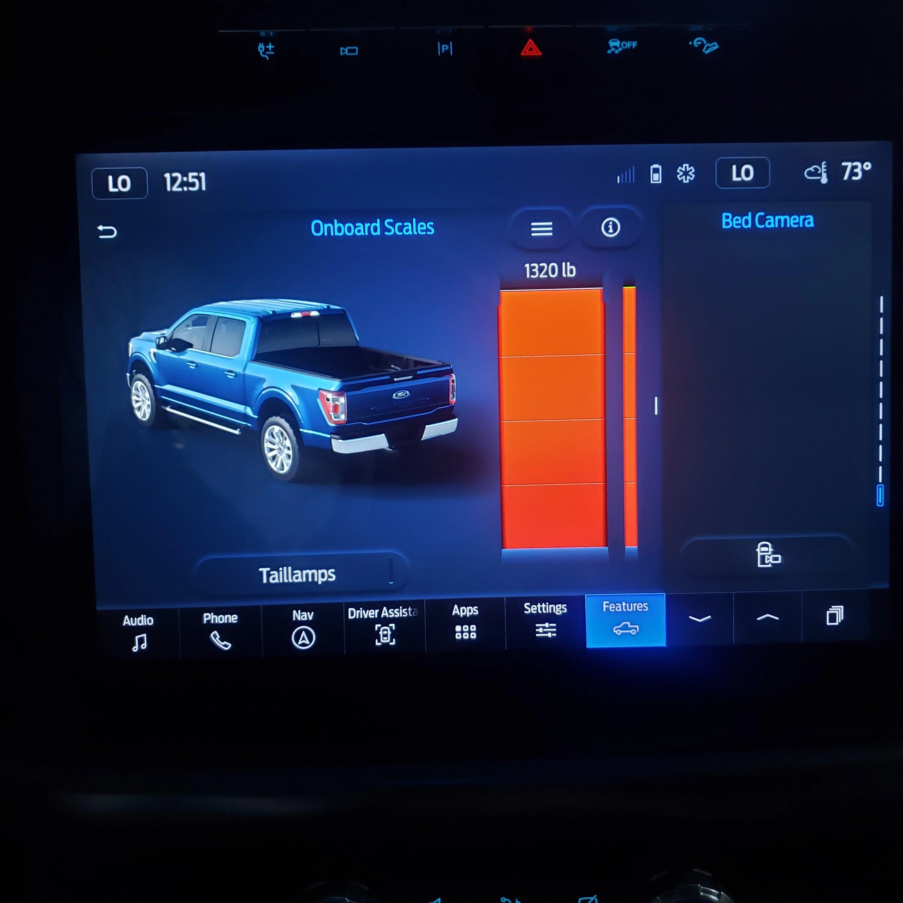

I have CCD. I never noticed the ride. Better? Worse? I couldn't tell. I said noticed because right now the ride height sensors think my empty truck is overloaded. I installed lowering shackles so to the sensors the truck is squatting. I can't tell a difference at all between before and after lowering. I would like to know if there is a way to re-zero the ride height? If I look at the onboard scales it is as red as red can be.

@oneinch I think there's a calibration routine you can run against your height sensor/scales to reset the zero point. I too have scales but only consider them a vague indicator. It's not capable of being scientifically significant to me, so I don't fret much. However zeroing it out can make you feel better at least. :)
I would think so, but I have no clue. I've never used the scales, but it kinda sorta bugs me the feature is useless now. I like the lowering shackles more than the CCD/scales. The choices we make.
I'll be getting an oil change soon. I was going to test the dealer's knowledge and willingness to help out. From the get-go they won't know, but will they try to find out? I'll see. If it can't be it's no big deal to me.
EDIT: I checked out scale mode on my truck. I can't use it because my payload limit has been exceeded. I can raise the truck with a floor jack under the hitch and the weight goes down. I can play around with this and maybe I can reset my scale.

I just tried jacking up the truck from the hitch. Sure enough and as I already knew, the truck scales reads this as weight being taken out. I switched to scale mode and zeroed the scale. As soon as I returned the weight of the truck back on the suspension it went to overloaded mode. I'm pretty sure the ride height sensors on the shocks need to be zeroed. Hopefully this is possible by the dealer or better yet with FORScan. ?
I am almost 100% sure FDRS has the calibration procedure available.
But I think I've read that Forscan now has the ability to calibrate too?
Don't take that to the bank though.
My truck....somewhere in the scale mode, it is very easily reset to 0, and it will ask how much weight in accessories are present during the procedure. No manual, software or hardware required. I can't recall the exact steps but it was a simple case of looking at what the other symbols on the screen do.
