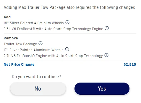

Other than tow weight and TC, What are your needs with the tow package?
google "build F150" and go through the build process. click on the little "i" next to the package.
https://shop.ford.com/configure/f150/chooseyourpath/
Ford F-150 Confused about packages 1671674263354
Ford F-150 Confused about packages 1671674316194
Ford F-150 Confused about packages 1671674333151

The Class IV hitch will be rated for 5000 lbs (WC) no mater what package you get and 10-14k (WD) depending on which package you get. Ref the link below.
https://www.f150gen14.com/forum/threads/upgrading-the-hitch-worth-it.14240/
My guess is the package offers different suspension based on the ride quality vs tow rating that you want. There could also be differences in engine options. I believe they have different payloads as well. Ref link for specs below.
https://www.f150gen14.com/forum/threads/2021-f-150-technical-specifications.139/
