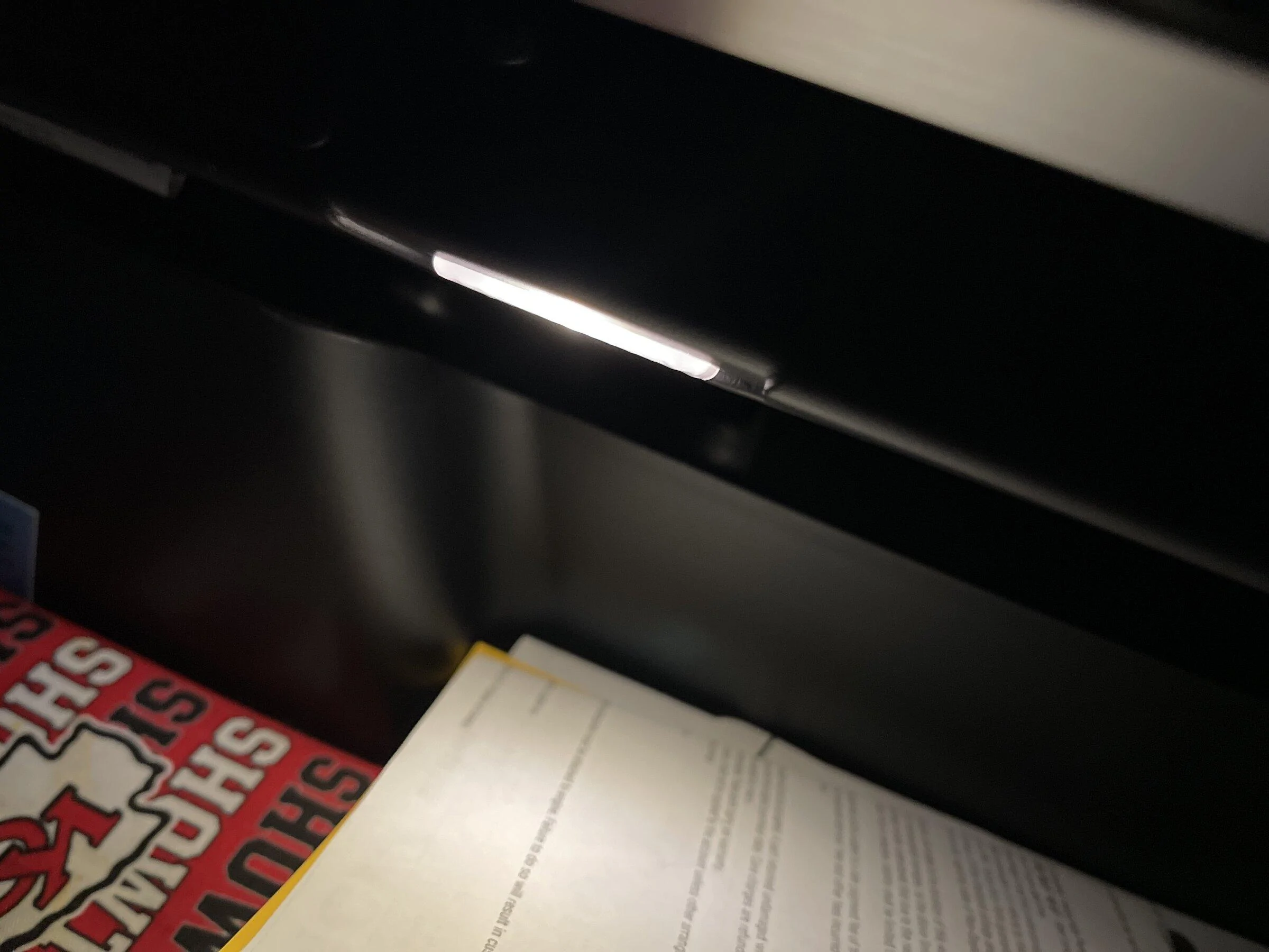

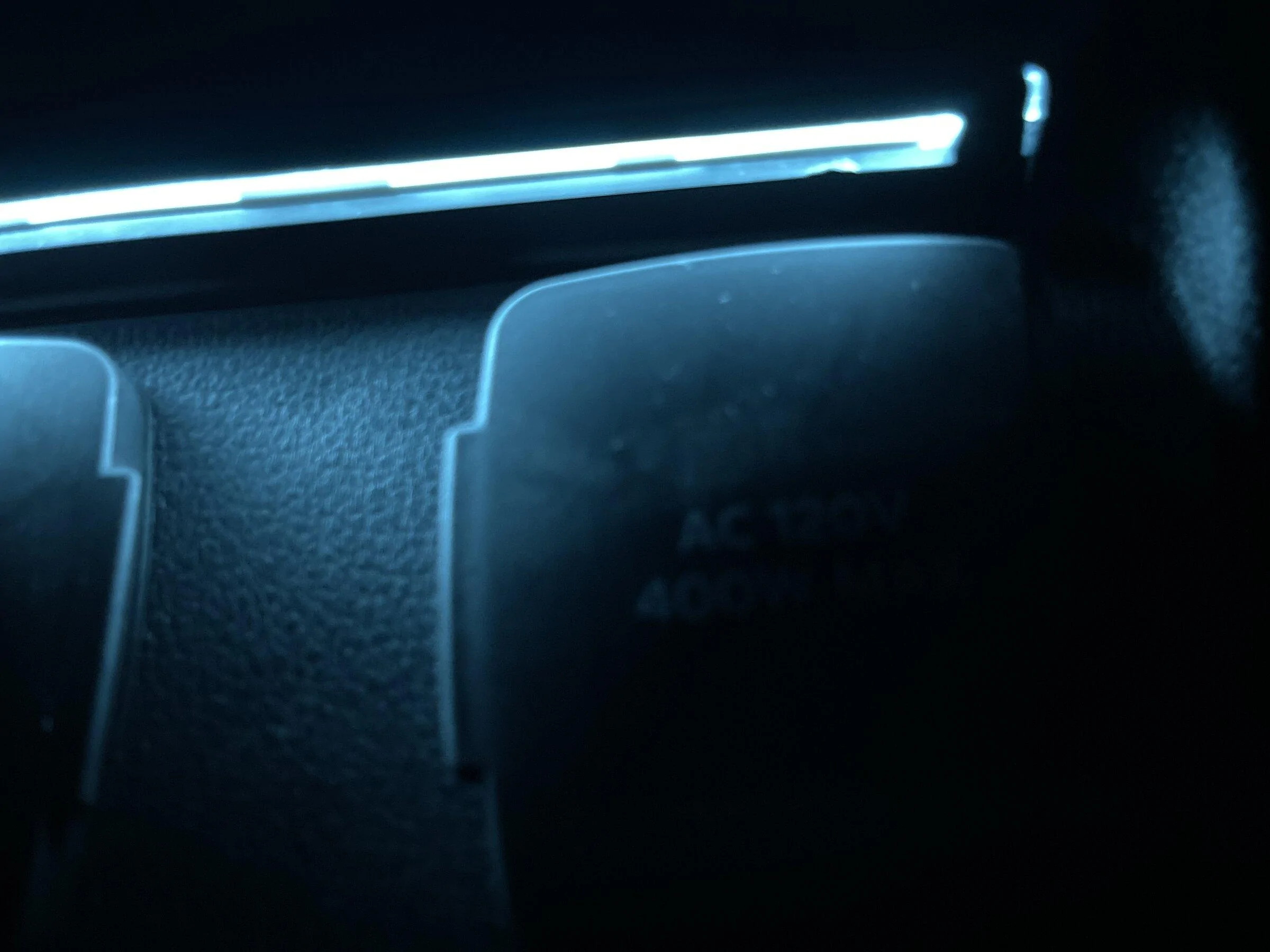

The 1st and 4th picture are normal and on all the time. That is part of the ambient lighting. The light in the glove box is up for debate since you can only see it when you open it up. I can’t tell where the other picture is from.

No, ambient light setting is toggled off. I know this for a fact because the ford tech showed me the wiring diagram and all these lights are on one circuit and not the ambient light circuit. Plus with ambient light option on the cup holder illumination is on and works w the sliding adjustment and they are never on until you open any exterior door on the truck then all the lights come on. And i have video from phone being in glove box and all other compartments lights are on and compartment doors are shut.

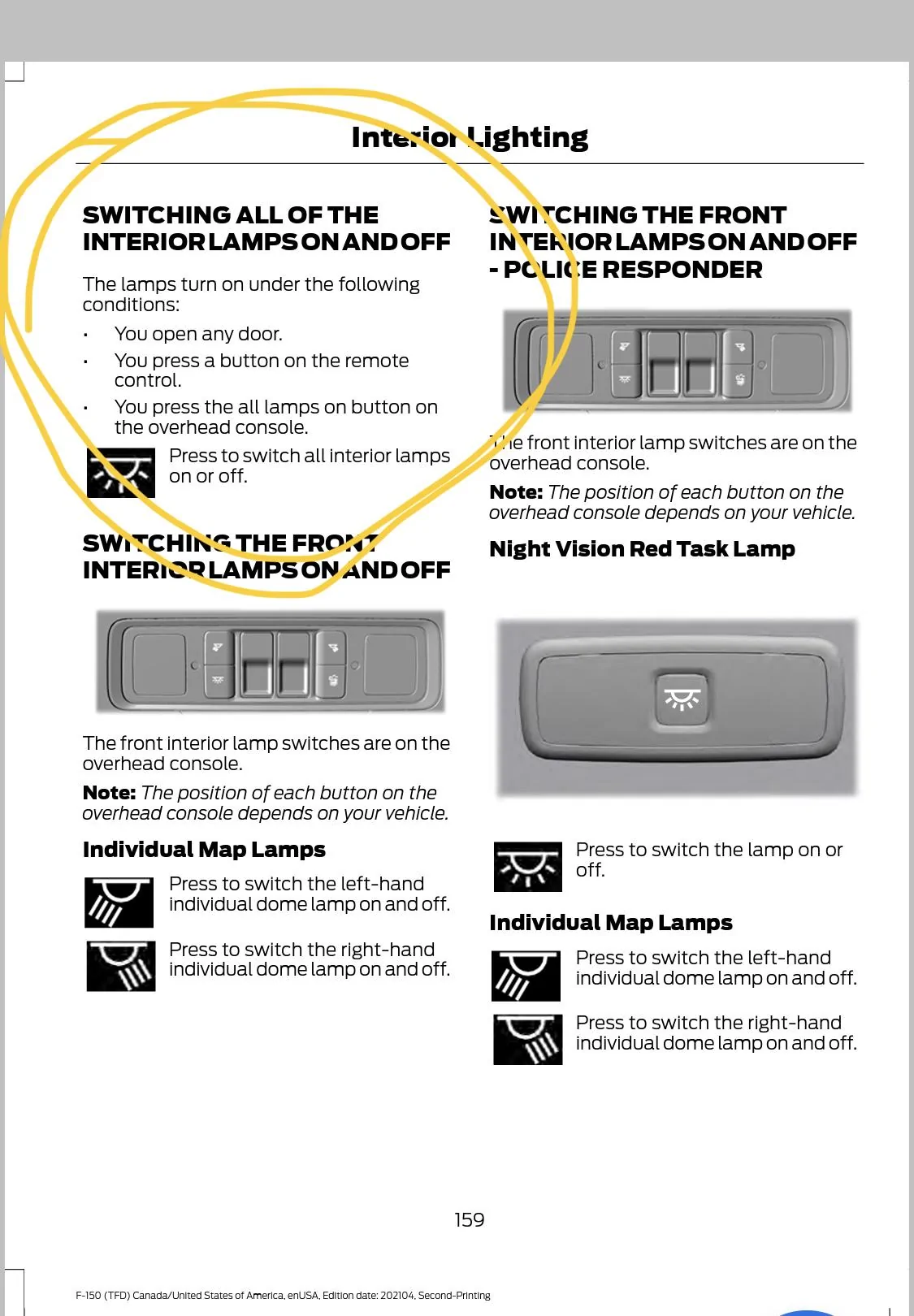

Not to sound like a douche, but you don’t have this button “on” do you? That button would turn all the lights on, all the time.
ya thats not it either
