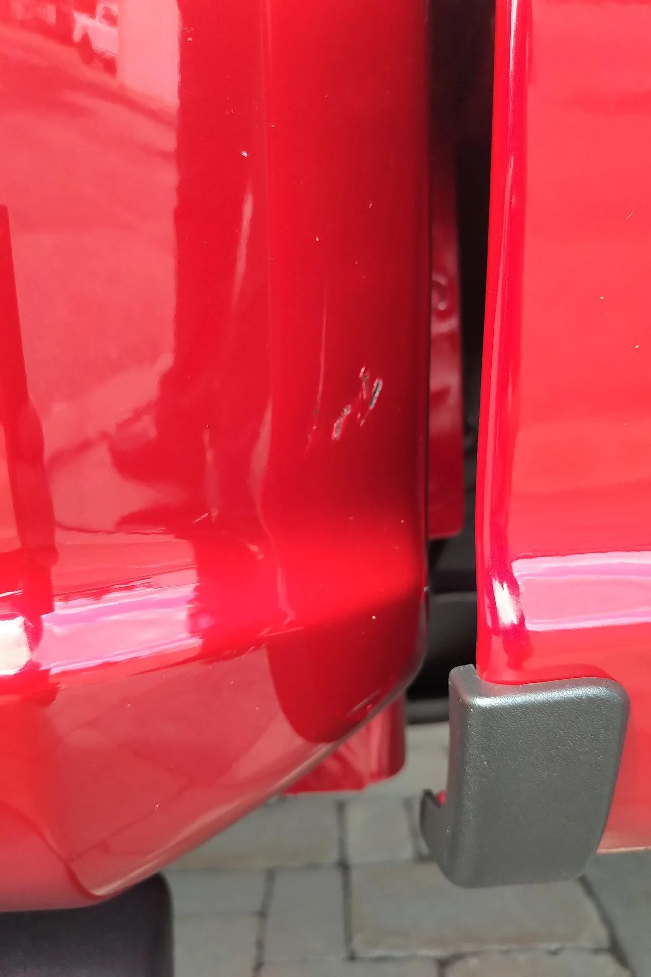

I picked my Lariat up July 30 and all was good. On Aug 4 as I was leaving my driveway I heard that horrible noise. Thought something broke. Took it to the dealer on the 6 and they were lost for words. They did find the box bolts were loose but not the issue.
Found out yesterday about the bulletin. Of course the u-bolts are on back order!
My truck also came with a nice gouge in the left rear cab corner. That goes to the body shop soon.
Hope this isn't a bad sign!
