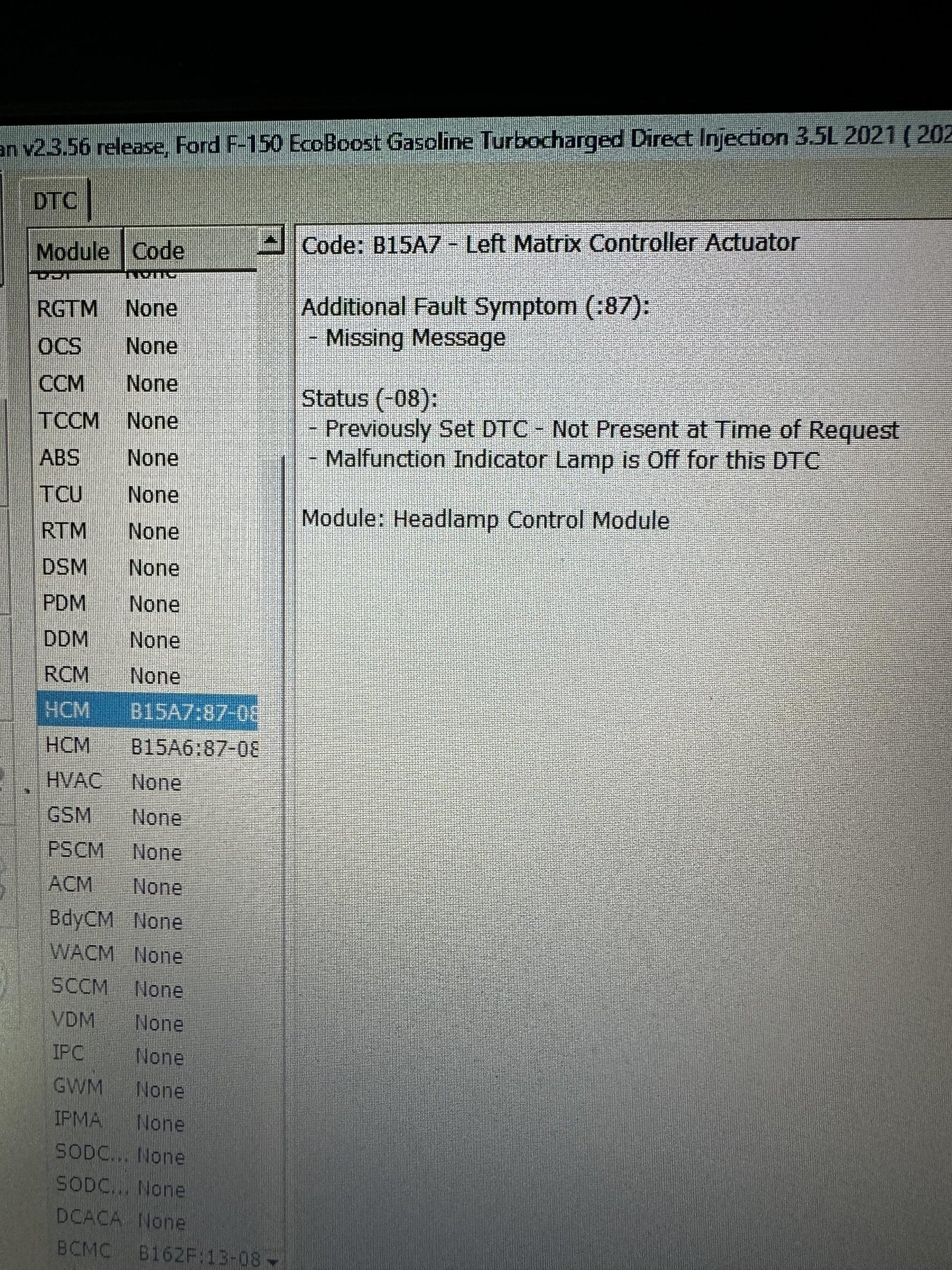

Mine is totally stock, 37PP Raptor. I had this DTC on both drive and passenger side headlights. Cleared them and they didn’t come back immediately.
Ford F-150 'Check Headlamp system' warning message IMG_3891
