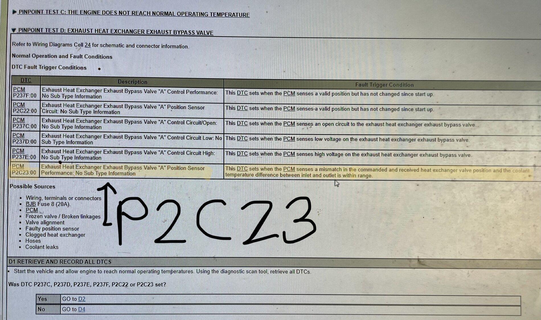

I have P2C23 CIL on my Powerboost.
I brought it to the dealer about 10,000 miles ago and they re-flashed the PCM per the TSB, but the light came back on within 30 miles of the dealership.
Does anyone know where this sensor is located? Or maybe just how to get Ford to change it without keeping my truck for 3 weeks?

Some of Service procedure for P2C23 - Exhaust Heat Exchanger Exhaust Bypass Valve “A” Position Sensor Performance: no sub type information - once re-flash doesn’t fix issue MIL.
Ford F-150 Check engine light. 21AFBF15-023C-49CD-AE51-1C0E35BC74AC
So, I was able to get the oil / tire rotation expert to look the P2C23 code up on the Ford Repair Manual in their shop. According to this document, it looks like it has something to do with the exhaust heat exchanger exhaust bypass valve “A” position sensor not returning the proper value when the commanded and received position information do not match when everything else is normal.
Someone had a hybrid with a pinched wire I read about previously, and the wire cause a totally different issue in the truck.
Ford F-150 Check engine light. 06D17DD9-906F-42CA-8DE8-46608B42BA23
This service procedure seems to take you down that route, as there may be a faulty harness allowing noise/resistance to cause interference with the signal.
