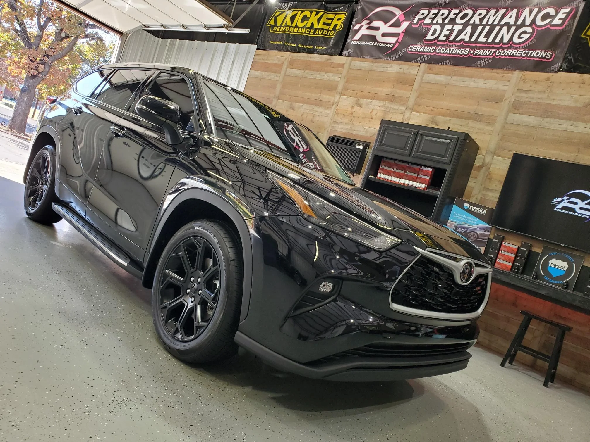

Nope, you can do anytime. But Ive had two done, 392 Charger and wifes new Black Highlander...looks super slick, paint looks so deep, and so easy to keep clean. Cleaning now is a breeze!
Ford F-150 Ceramic Paint Coating - school me IMG_20221112_131729_resized
Ford F-150 Ceramic Paint Coating - school me 38171735_240512819925057_6510560221847355392_n

I do both on my vehicles (I dont pay thousands to have someone else do the ceramic coating, but rather use Adams Graphene Ceramic Spray myself for $50). This particular DIY ceramic will not last nearly as long as some of the professional jobs, but I do it when I first get the vehicle so very little paint correction needs to be done, and then do it yearly. But the PPF always goes on before even leaving the dealership so that I mitigate rock chips. The ceramic coating helps the car stay cleaner longer, makes it easier to clean, and makes it look awesome when clean (as pics above show).
