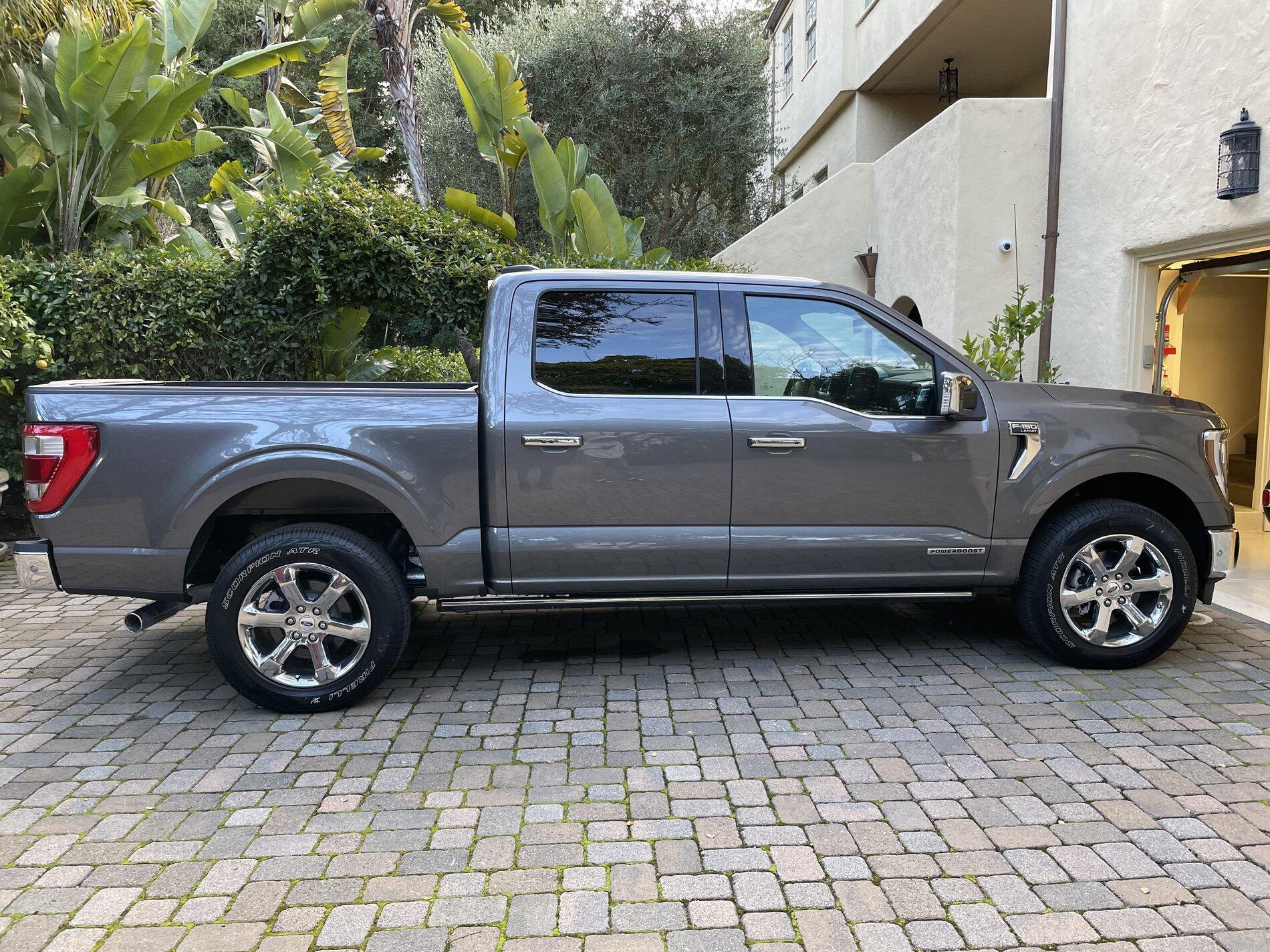

I did it myself, as I've done on two other cars. Since it was new, I didn't have to correct the whole truck, just a few spots, including the black b-pillars on both sides. I use gTechniq CSL and Exov4 as follows: Wash > limited correction > clay > chemical surface prep > one coat CSL > two coats of Exo. My other cars are past year three with the same treatment, one parked outside, and still bead extremely well. I'm very happy with the gTechniq products. They go on great, and look good, and last well. The total cost was about $150 plus about 6 hours of work.

Based on your comments and the gorgeous photos of your Smoked Quartz truck, its clear that you know your stuff. Are you a professional Detailer? Given how perfect it looks, and that it took you only 6 hours to prep/correct/apply the Ceramic Coating, leads me to conclude you are. (Either that, or you missed your calling!)

I only needed to do minor correction plus the black B pillars.
For the glass, I’ve tried the gTechniq products but they didn’t work any better than RainX and they don’t last as long .So I just cleaned the glass with diluted isopropyl alcohol and applied RainX
I didn’t need to protect the black plastic surfaces while applying the ceramic. But I do use Griot’s plastic and trim conditioner from time to time.

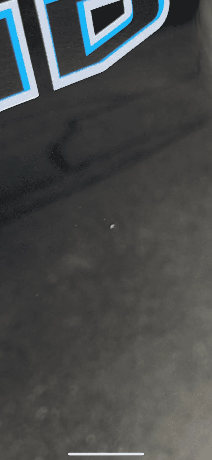

I will say I found more dirt nibs in the paint than I had hoped, KCAP needs to improve their paint shop dirt management. I did wet sand and correct a few, but one of them is to big to correct.
Ford F-150 Ceramic Coating - Price and Details Thread 0BB56DCF-40F8-4711-A2EF-0807F894A428
