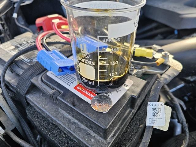

For those that have it installed, do you actually catch a reasonable amount of oil? Are you glad you installed it?
You made me go check, thank you. Yes I'm glad I installed it.
Here it is today with 4,565 miles since the last oil change in October with about 75 milliliters or 2.5 ounces or 1.3% of the total 6 quart capacity of the motor. Passenger side only, I didn't buy the drivers side. Probably should have, I think my reasoning was comments from others online saying drivers side doesn't get as bad (why?) and B) passenger side was dead simple and easy to install.
