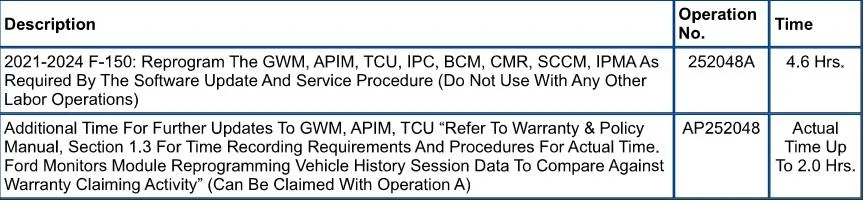

My truck is going into the dealer next week to correct a range of issues (software and mechanical), including the CarPlay issues described in TSB 25-2048. They're providing me with a rental car and I assume the work will require 2-3 days.

TSB took my dealership 2 hours, as I only had 2 modules that needed to be updated. It did not fix my issues though. I still drop wireless Carplay when I get close to some high power transmission lines. When I drive my wife's Kia on this same route my phone does not disconnect from the wireless carplay in that vehicle, so it would appear that Ford is using some frequency that is more easily interfered with by outside signals.
