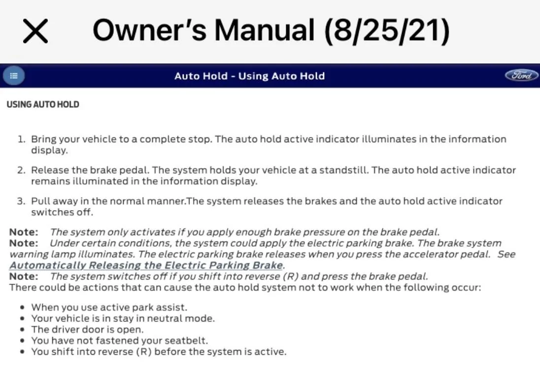

If you press the M button by the shifter after you put your truck into neutral it will disable auto hold and the parking brake allowing your truck to roll

Just a situation where it's important to read the truck manual before getting too upset at a feature, as many above said Ford should include a button, and they essentially did. With how infrequently I have to disable Auto Hold (has been 0 times so far since I won't take this truck through a car wash), I am glad I don't have another button clogging up the dash instead of how they did it and reuse an existing button.

I saw someone say that if you unlock your seatbelt it disables the autohold. I "think" this works I've only had my truck for 2 weeks, and usually parallel park at work. I'm currently driving my old truck while trying to sell it. My new truck mocks me every time I walk by and it lights up, I feel like it is telling me "don't you want to drive me instead? ha!")

If you are not pressing brake pedal (or pressing lightly) prior to shifting to Park this will cause the Park Brake to apply or if you are opening door and not shifted to park or transmission has not fully engaged park. (safety feature)

Yes, the AutoHold hard button was removed to reduce the amount of buttons and moved to menu, if you like it and turn it on and know how to disable prior to entering car wash.
