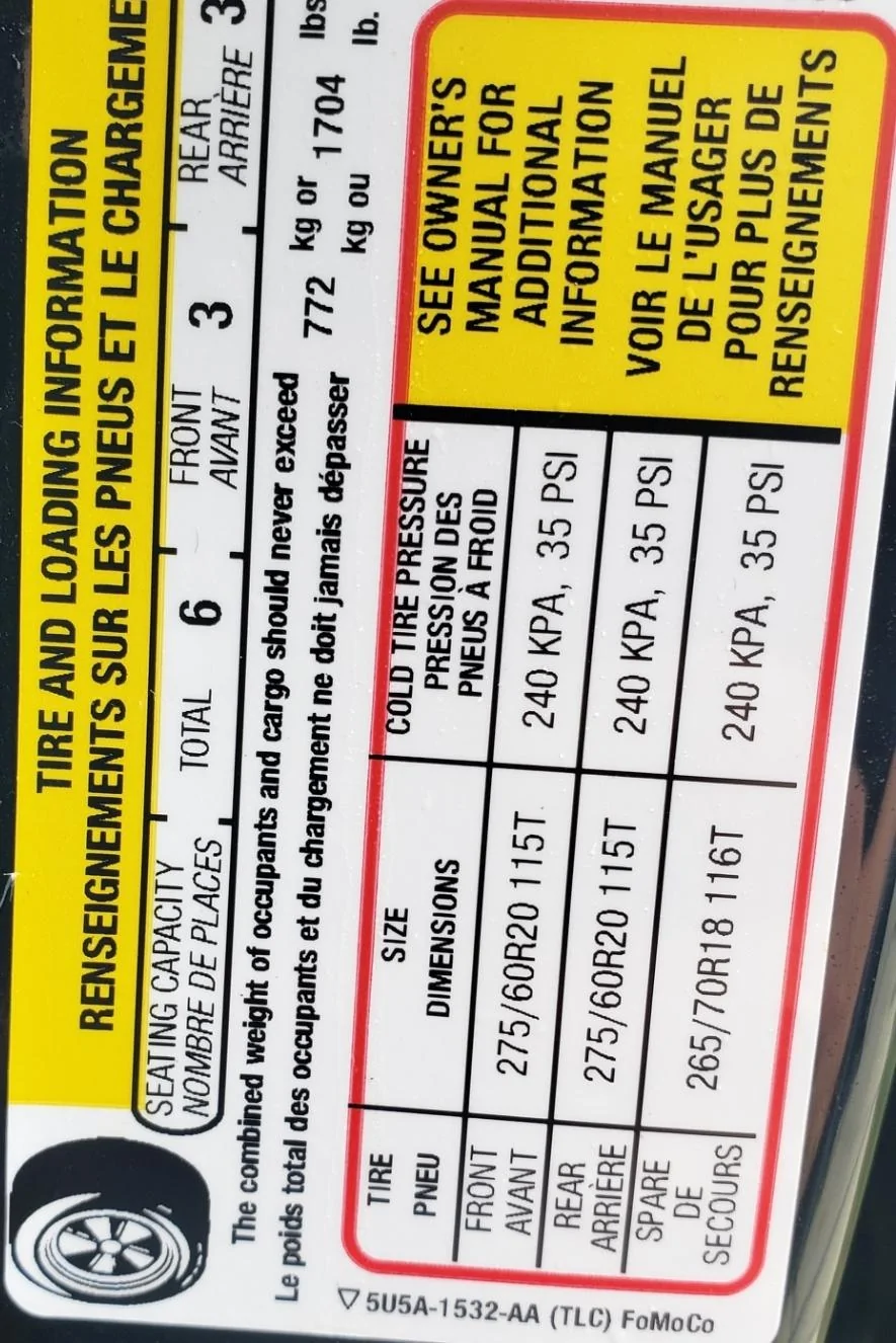

In Ontario ?? and looking at ordering Cooper Snow Claw for the winter. I see the spare is an 18" wheel, could I drop from the 275/60R20 or do I have to stick with 20s? Will be ordering new wheels for summer and putting snows on stock wheels. Could I still tow a travel trailer with the snows on with the different sidewall height, now sure if it affects payload? ?

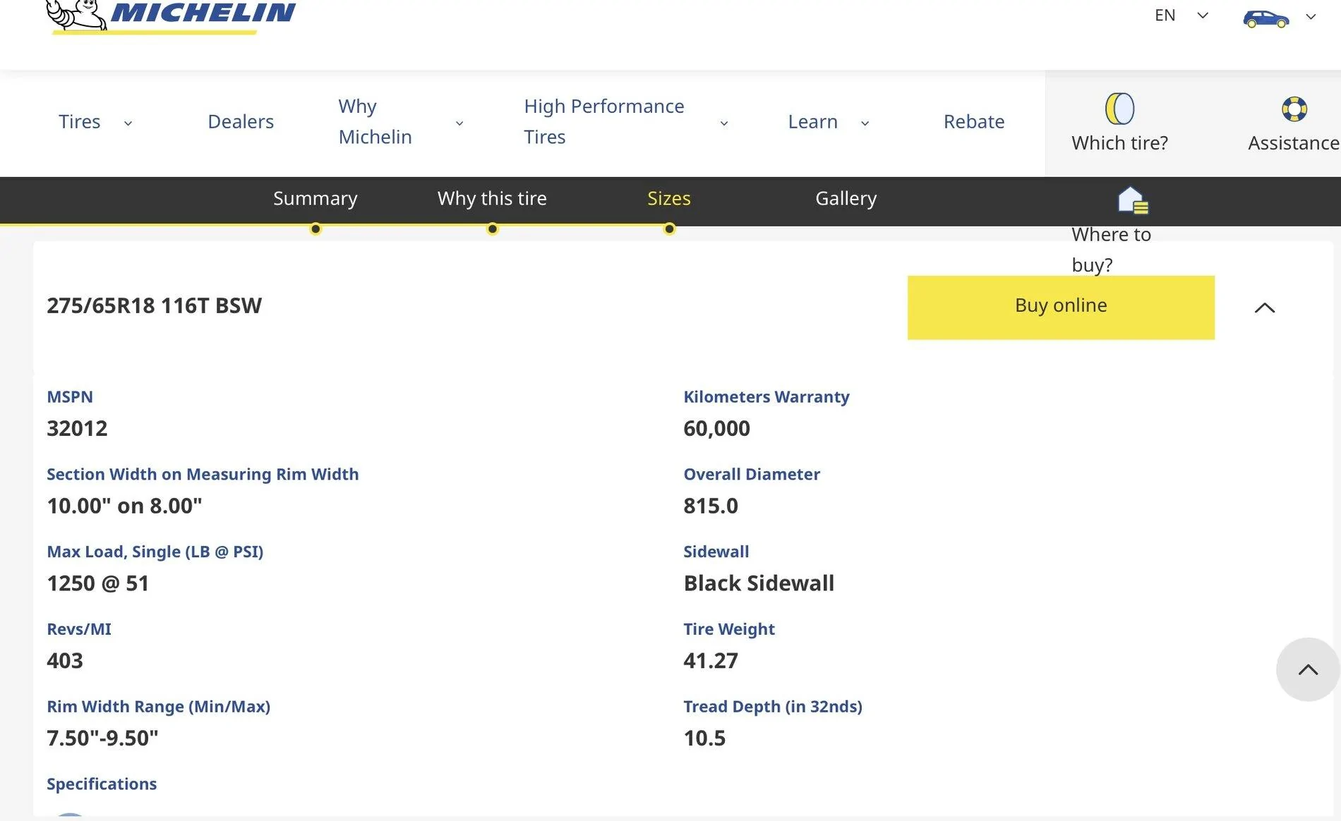

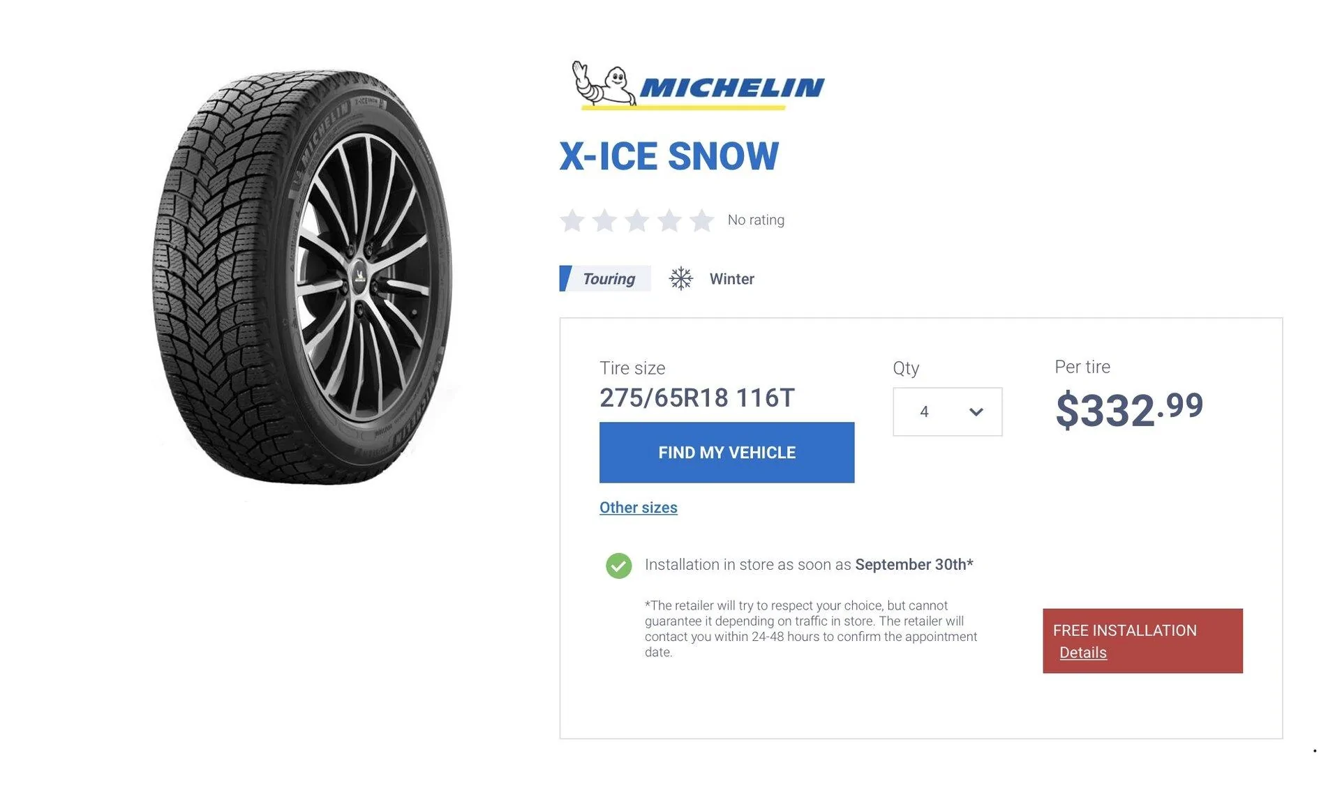

I don’t see why not. My PB only has a 1320 payload rating , no max tow though, and this is what I put on for the winter snow tires. At 1250 a tire that should be fine. There is a decrease in the speed rating of 3 km per hour though.
In Ontario as well. The ride is pretty good, not really much different from the 20 inch tires. I couldn’t find any in the 265/70/18 size.

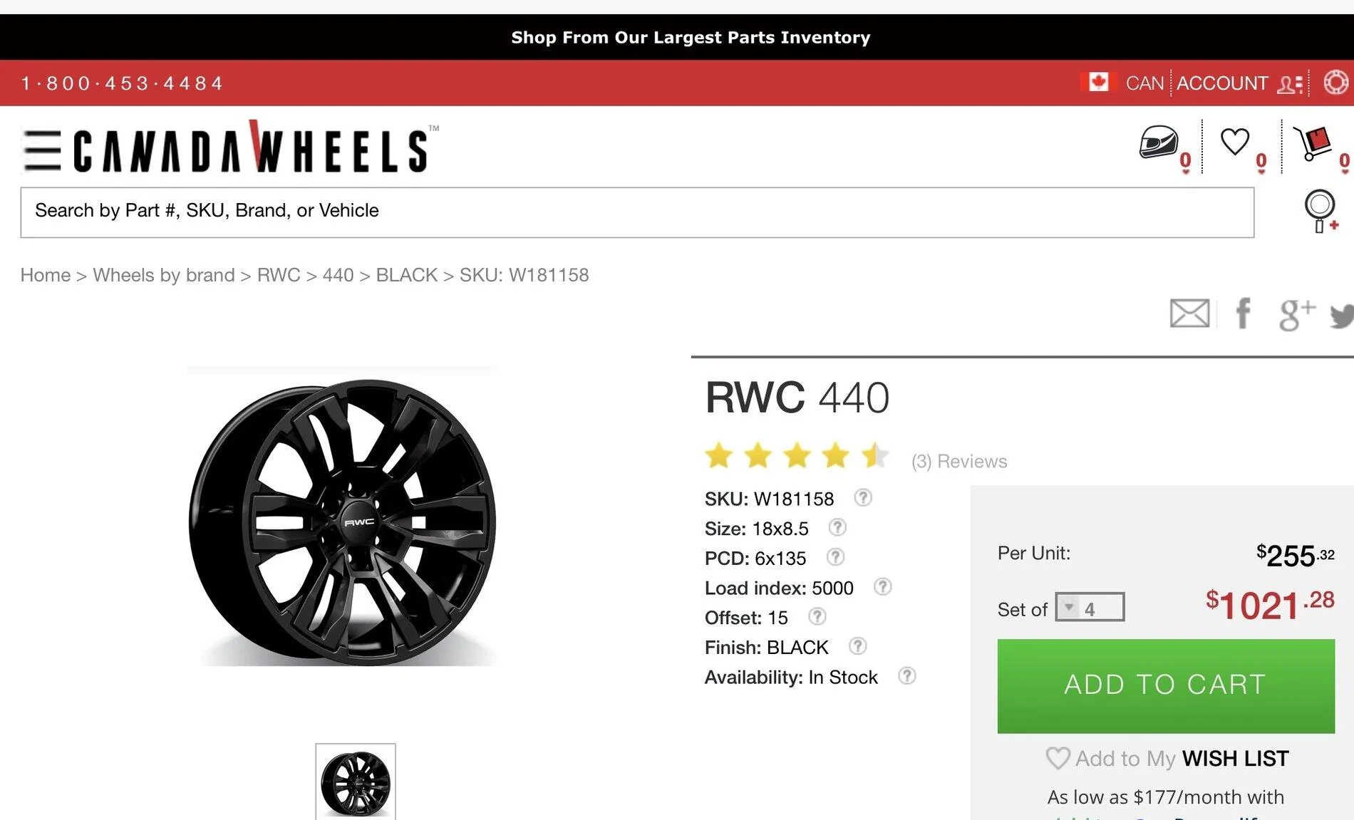

https://www.roadreadywheels.com/products/2004-2020-18x7-5-ford-f150-steel-wheel-rim
Don't know if they ship free to Canada or not.
Keep your eyes open for take-off wheels, I see alloy sets in 18" pretty frequently between $500-900 with tires already on them. Even though steelies are the traditional winter tire wheels, there's no rule against using one of the less popular OEM alloy sets and you won't have to worry about rust!

It shouldn’t be an issue, the max tow still comes with 18” wheels when you get the sport package.
