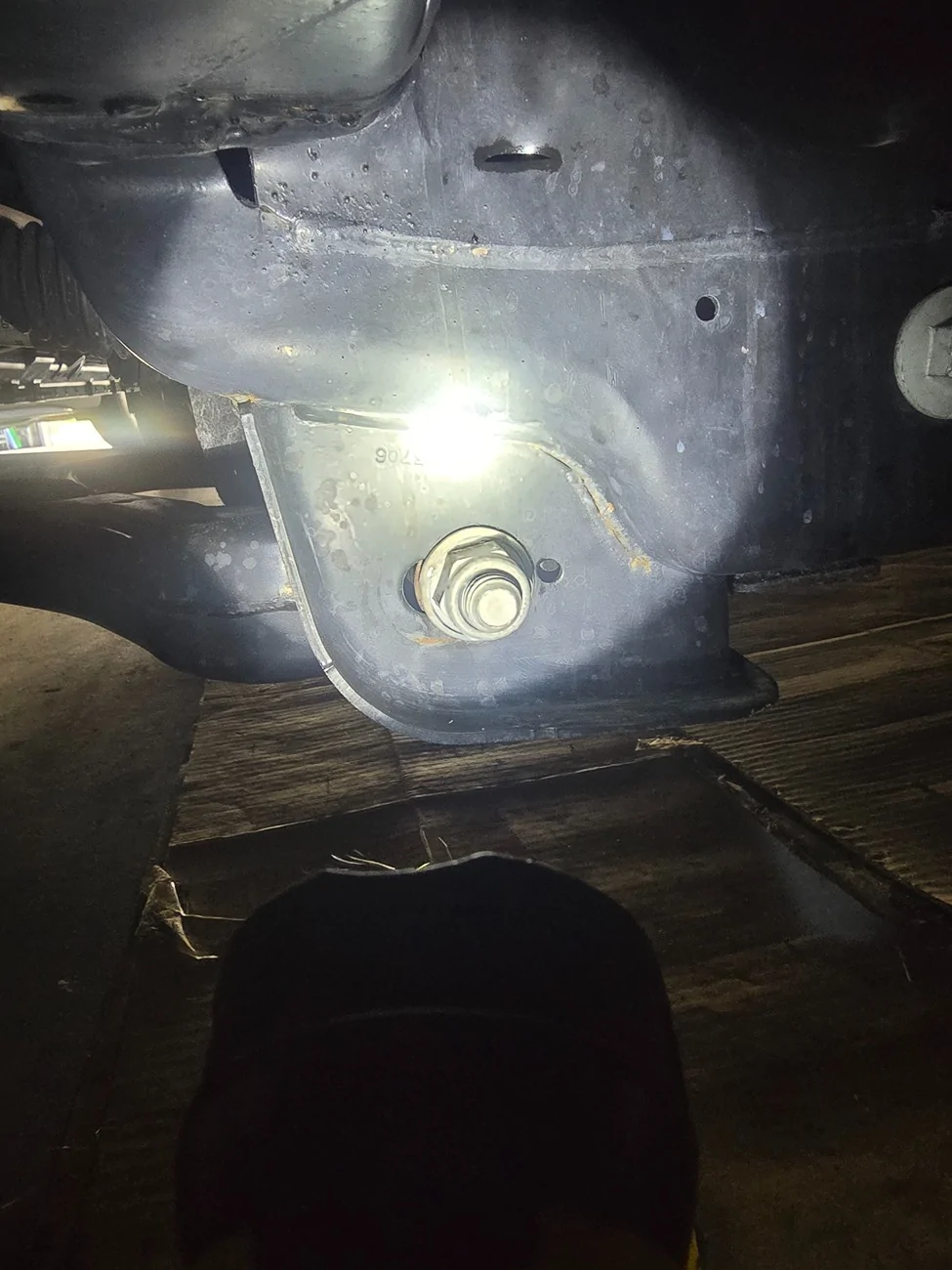

Had an alignment done yesterday after a 3/5 drop.
I did the 2.5 drop struts from maxtrac.
Positioned at the 3rd Ringling.
The alignment shop pushed my lower control arms all the way inward to get as much adjustment as possible. Im still 1.5 degrees off on both sides camber.
Castor is out 6.4-6.5.
My question is would a camber kit even help at this point?
My lower control arms especially the front look like they are maxed out all the way inward to the point I can see space between the bolt and frame

When i lowered the front of my truck i had the dealership do the alignment as the do a lot of custom stuff. They notched the holes on the lower arms to get the alignment right. Its been almost 3 years now and all is good.
You can do this and grab the 12.9 grade SPC nuts and bolts to make sure it stays in place.
